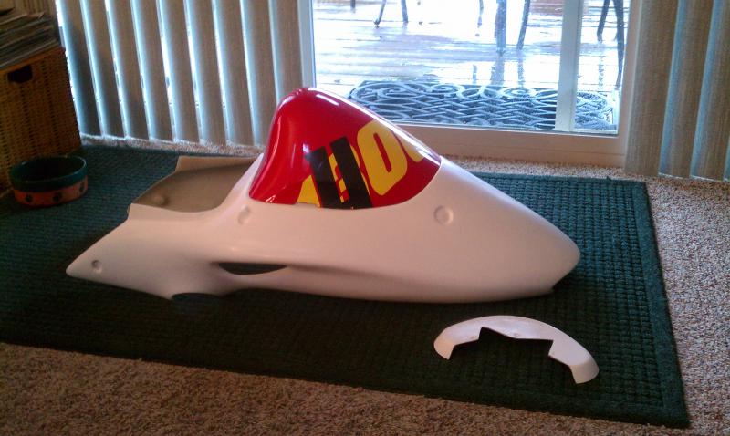

i'm strectched out 7-8" never rubbed make sure you get some adjustable dogbones from Soupy, and I just got a 6"+ tail from airtech . they are $228 very nice and I got the one where you can still use the hump.
frisbee
GODSPEED RACING
Mar 19, 2002
15,645
106
The small piece is for the tailight its is $33

Guys there is a huge difference in the rubbing on a gen one and gen two. I forgot to mention on the airtech tail you will have to mold our tail light and turn signals in place but your painter should be able to do it.
