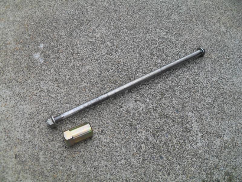

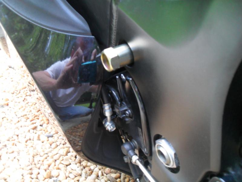

I did not know until I recieved the lift that you must add a sleeve to the upper engine mount bolt for the upper pin on the stand to fit into. I removed the upper engine mount bolt and put it back in from the opposite side of the frame. Then instead of putting the stock nut on, the Bursig sleeve is threaded on instead(I put some locktite on it).

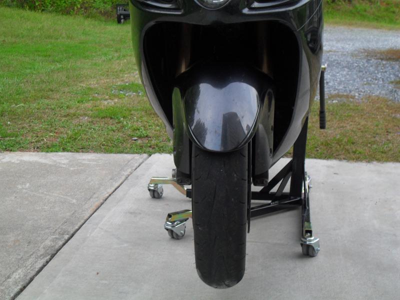

The front wheel is currently 3" off the ground, and the rear is 5". This can be adjusted by the paralell threaded rod above the pins. I'm going to shoot for the opposite, 5" front and 3" rear, or there abouts. At least to get the front high enough to roll the front wheel out without removing or loosening the front fender.

Upper pin sleeve that replaces the nut, and bolt is put through from the opposite side.

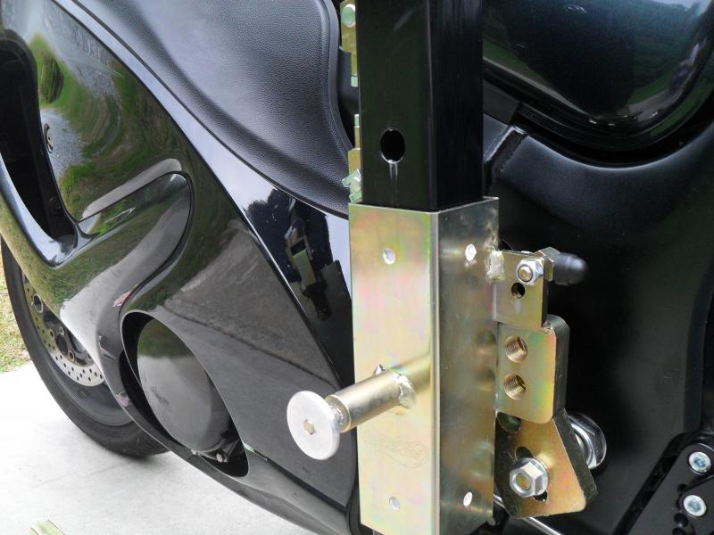

The round knob on the back of the plate is a spring loaded pin. When you lift the bike all the way up it pops in and locks the stand in the lifted position. The hole in the black part of the frame above it is where it locks into.
To lower the bike you just put slight pressure on the handle, pull the knob out, and the bike sets down smoothly and easily. It is not a hard drop, or that you're supporting 550lbs on one arm at the handle.
The handle looks much closer to the tank in the first picture than it actually is, there is plenty of clearance.

The paralell threaded rod adjusts the heighth of the front vs. rear of the bike. You can have the bike level, or the front or rear higher than the other.
Top right is the fixed pin that fits into the sleeve on the bike.
The large bolt head in the center is what bolts the Busa plate(or whatever bike you have)to the stand itself.
The lower left pin is what is adjusted by nut on the back, to make for perfect aligment of the two pins into the bike.
The threaded rod on the end of the handle(on the very top right of the stand)is also adjustable.
This is so you can roll the stand against the bike and the pins will go right in, without having to move the handle up or down for the plate to line up. It just makes things easier.

The factory nut is removed from the throttle side of the bike, the bolt is pulled out from the other side and then put back through from the throttle side.
Instead of putting the factory nut back on you just thread the gold colored sleeve on in it's place, very simple.
