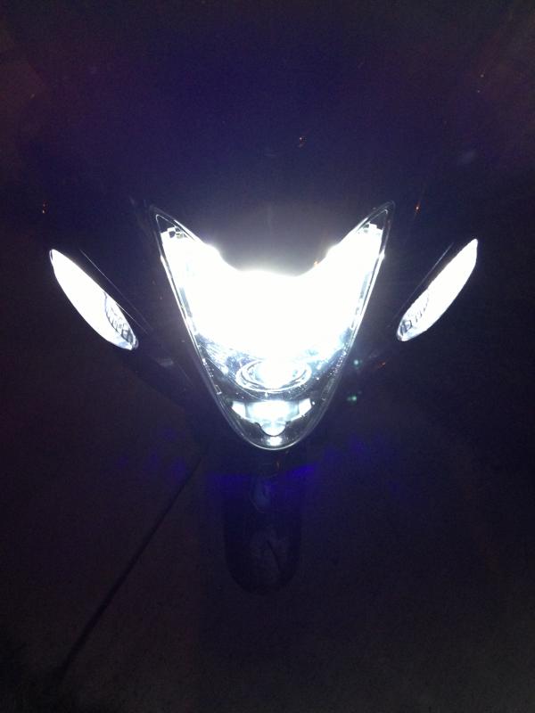

I didnt worry about ign or anything. Since i had the nose off, the easiest and most sensable thing to me, i just spliced into the low beam RL power. Its not enough draw to worry about. No problems in the 2years i've had mine modded

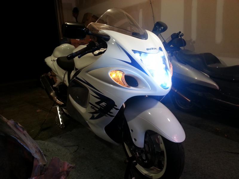

i just did this mod last night it makes aworld of differents to me in looks i used the plugs out of my oldsmobile cutless 1984 a little sanding and they fit right in

the 60 LED's will fit inthe gen II and power can be pulled from the little lights in the corner of the headlight very simple mod to get done.

$1.50, 1157 sockets from your local auto parts, pull the old socket from the oem plastic base and some connectors and your done.
