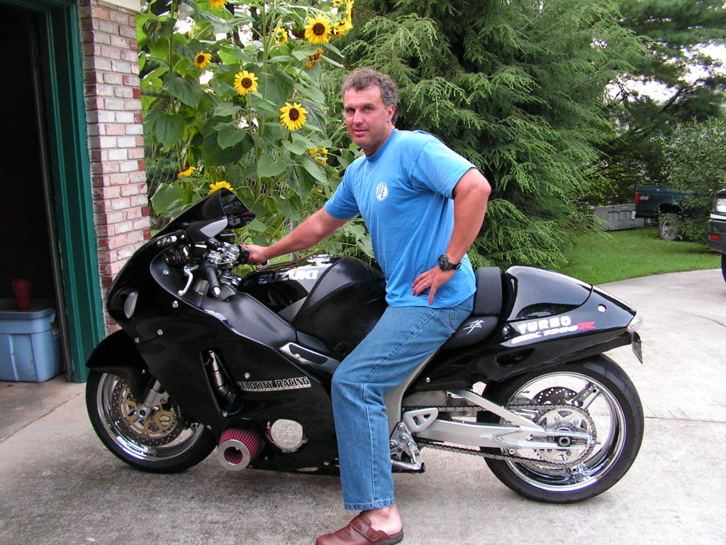

FROM 250HP TO 427HP
just peel that huge "TURBO!!!" sticker off, and you're good to go. lol, and john mayer wants his shoes back. looks like a nice neighborhood, super nice bike. we need to see some vids with that disco potato a spinnin.
o snap, just realized there's a gen 1 and gen 2, both black, both stretched, both turbos. damn, i really like where your head's at.

The turbo is a GT2871R,.....(bigger than the Disco).........with a little "magic dust" sprinkled over it!:poke:
