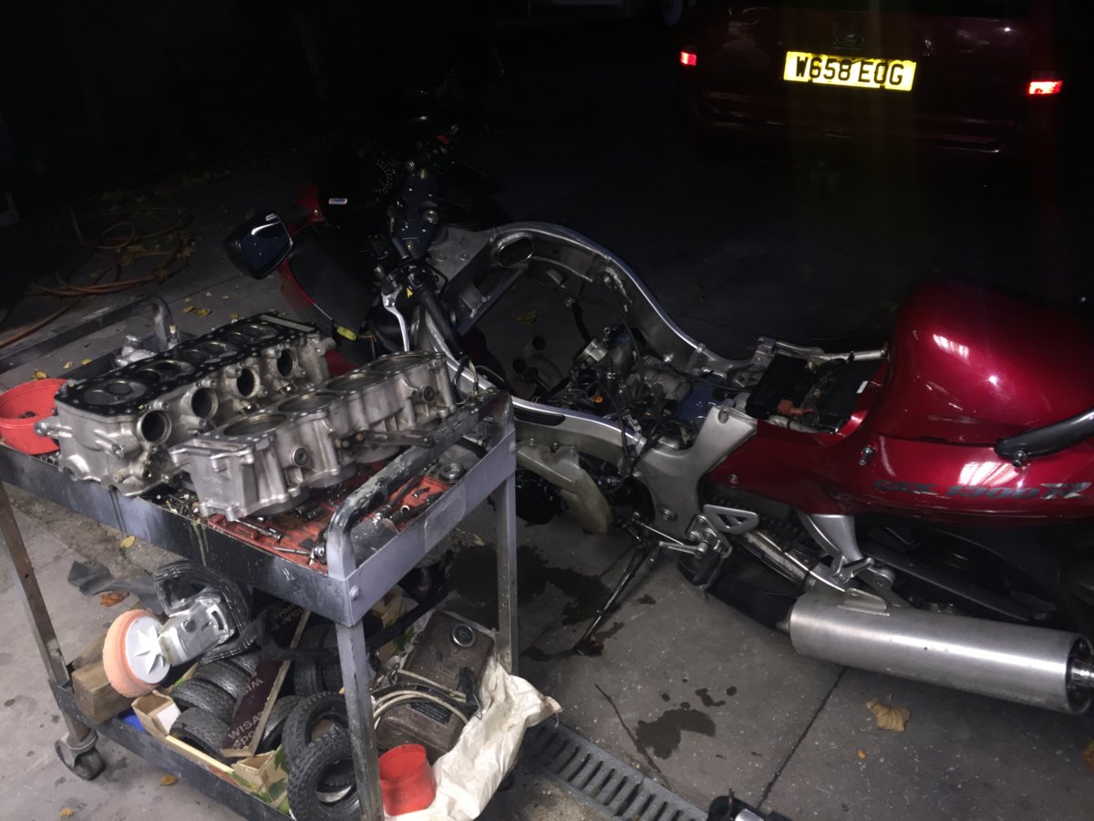

Hi Karl.

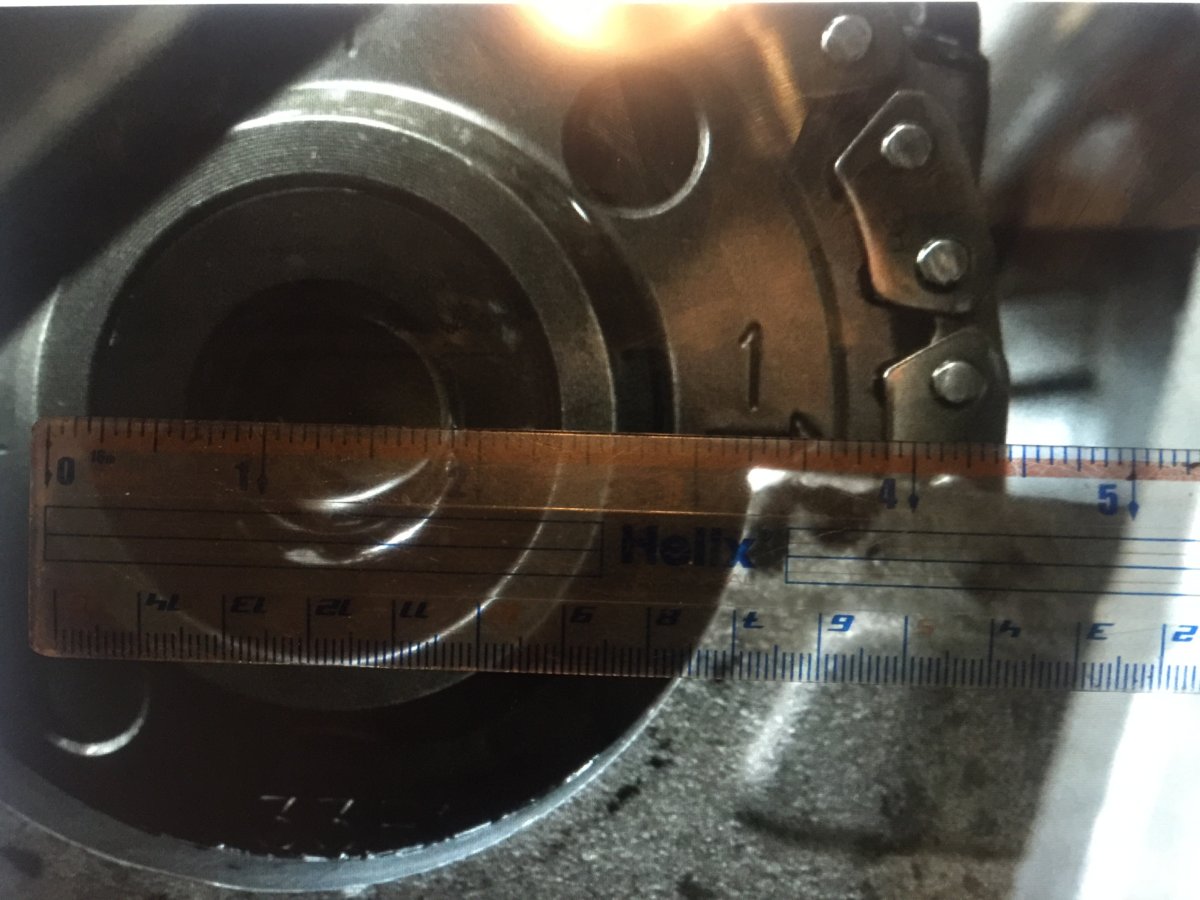

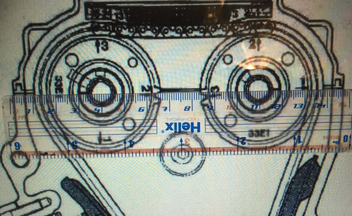

Yep, famous last words, I've had ongoing problems, after speaking with a couple of experienced busa mechanics, they think that I have excessive wear on my cam chain, throwing my timing out, its possible I guess, given the 40,000 miles om my bike and it's terrible service history, so, I have the cams out, timing chain off and have ordered a new chain, hope to get it around Tuesday and go from there, my timing marks have never lined up as per book, so, if anything, I can eliminate the chain.
How many miles has yours done? One of the guys I've been speaking too said that he'd of changed the chain before 40k regardless of service history.

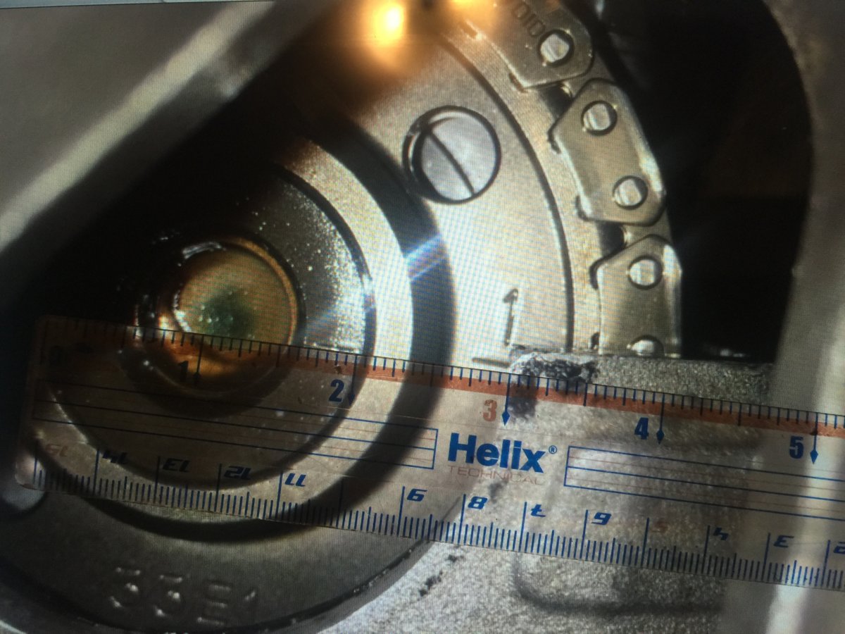

Got my timing chain off, here's a quick check, as you can see, it's got a lot of movement in between the links, easily half a tooth, I think this is my original running problem, my timing marks never lined up, as per the book, either the cam mark was too high or too low, I'm optimistic (again lol), new chain is ordered, hoping for some good news soon.

My marks are doing the same after installing a new cam chain.

I've heard of people having a hundred thousand kms on their bikes with the same cam chain but I guess it is all dependant on how the bike was looked after and ridden...
