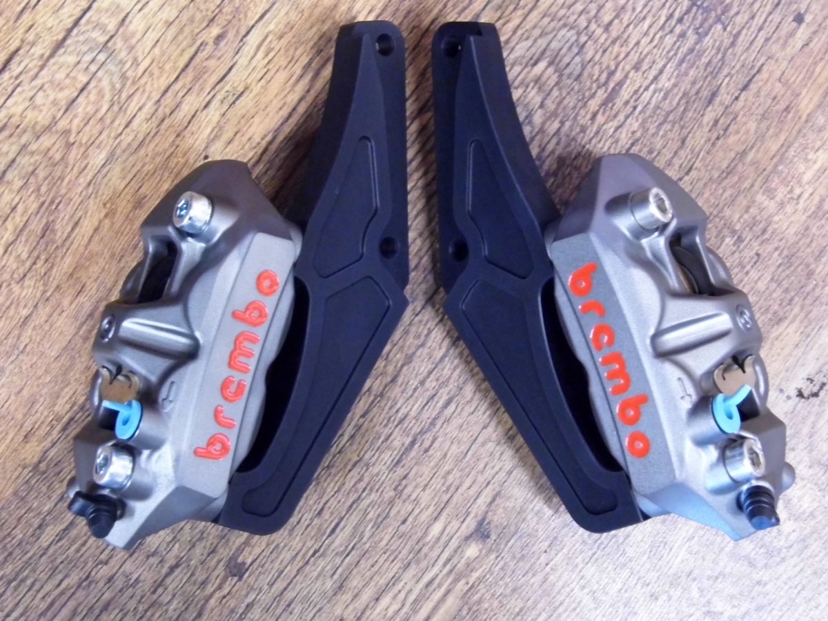

cancel harris.. found these... at least they look robust and are billet and anodized....
Red05
Jan 12, 2005
9,530
7,341
I like those! Are those one off or are more available?

adapters are less than 200...

on a side note... these are the ONLY ADAPTERS that are available in 108mm trim that are made from 6061 t5(tempered) billet aluminum... pretty much as strong as it gets.... the other adapters were 6060... and everything from AGRAS is 6060 also I believe.... anyhow... u must write to this guy on ebay….. https://www.ebay.com/usr/trc0928 he is the ONLY one I found with 6061 material
