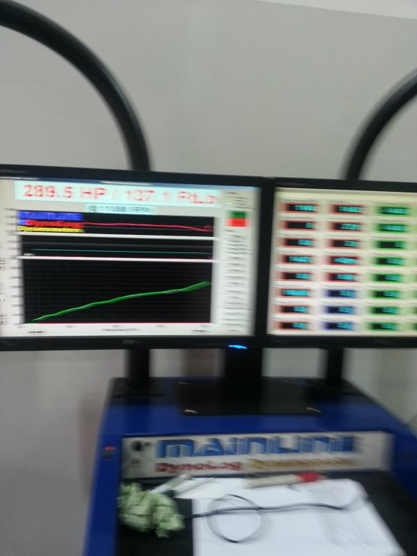

2009 hayabusa
83MM Wossner pistons
SS valves
APE Springs
Titanium retainers
All head work done by Frank @ Powerhouse
WebCams
Dyno'd
289 whp

i think a stock busa dyno'ed 210whp on the same Mainline dyno, while on dynojet it's around 180whp.. that's around 30whp or 16.7% more than dynojet..
if we take 30whp off the 289whp, that's around 259whp, or 16.7% decrease that's around 247whp.. which is reasonable imo.

I expected to see around 240-245 with that setup, but that would be with a Dynojet dyno. Kudos to whoever put our parts together and degreed the cams . . . the bike did good.:laugh:

If you can get even 247 whp out of a 1407(83mm)that's more than Carpenter gets out of his 1441,i'm sendin' my engine over to your builder.:thumbsup:

So Frank....how do you charge for a 84 mm kit with head and cam package installed?

PM the OP for a quote :whistle:
that's not my bike anyways.. but i believe you couldn't disagree with Frank's expectations.:laugh:

Your saying this 83 mill with head and cams? You spraying it. Because that number is high. I have a carpenter 1441 and on MR 12 made 240 plus. Think your Dino is very happy.

Actually the OP is a little off here, the pistons are 84mm, which makes this motor a 1441. And yes, it was determined that his dyno is approximately off around 16%, so this motor did make around 240 rwhp . . .:laugh:

Thank you Frank,a 1441 is more like it.:laugh::thumbsup:
