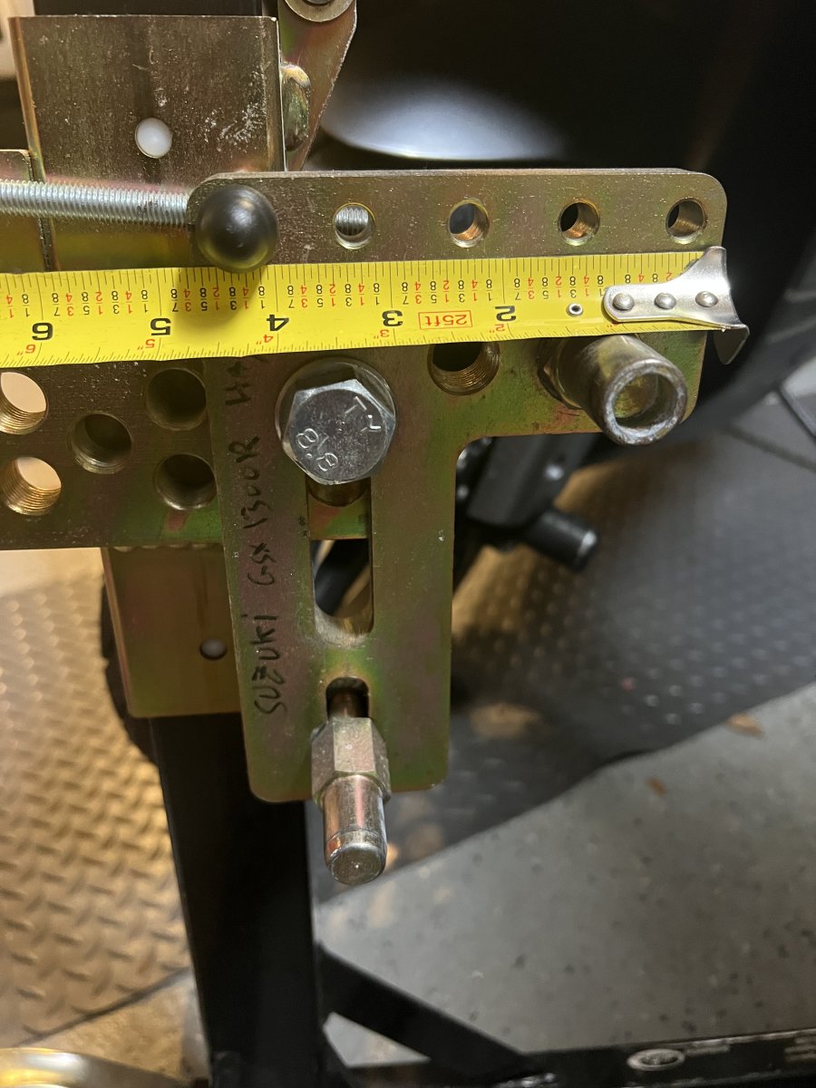

Can you post a picture of the top of your Bursig stand?
Did you get the sleeve that threads on in place of the engine mount nut?(probably not).

There is a flat plate with several threaded holes, plus 2 threaded pins that can be moved to different locations on that plate.
I can take pictures later.
2 pins, 1 sleeve, and 1 plate would not be cheap to have a machinist make, but they are not complicated either, a lathe, bandsaw, drill press, and tap are all you need.

I’m glad that helped. I’ve seen some simplified versions of this plate using what looks like a 2 or 3 inch flat bar with 3 holes. One for the pin that slides into the swingarm bolt hole, one for the pin that slides into the sleeve that’s added to engine bolt and one in the center for the bolt that secures it to the stand itself. Maybe that would be easier to make since mine seems to have been made for several different applications.
Edit:
Added picture of the other plate style I’ve seen.
