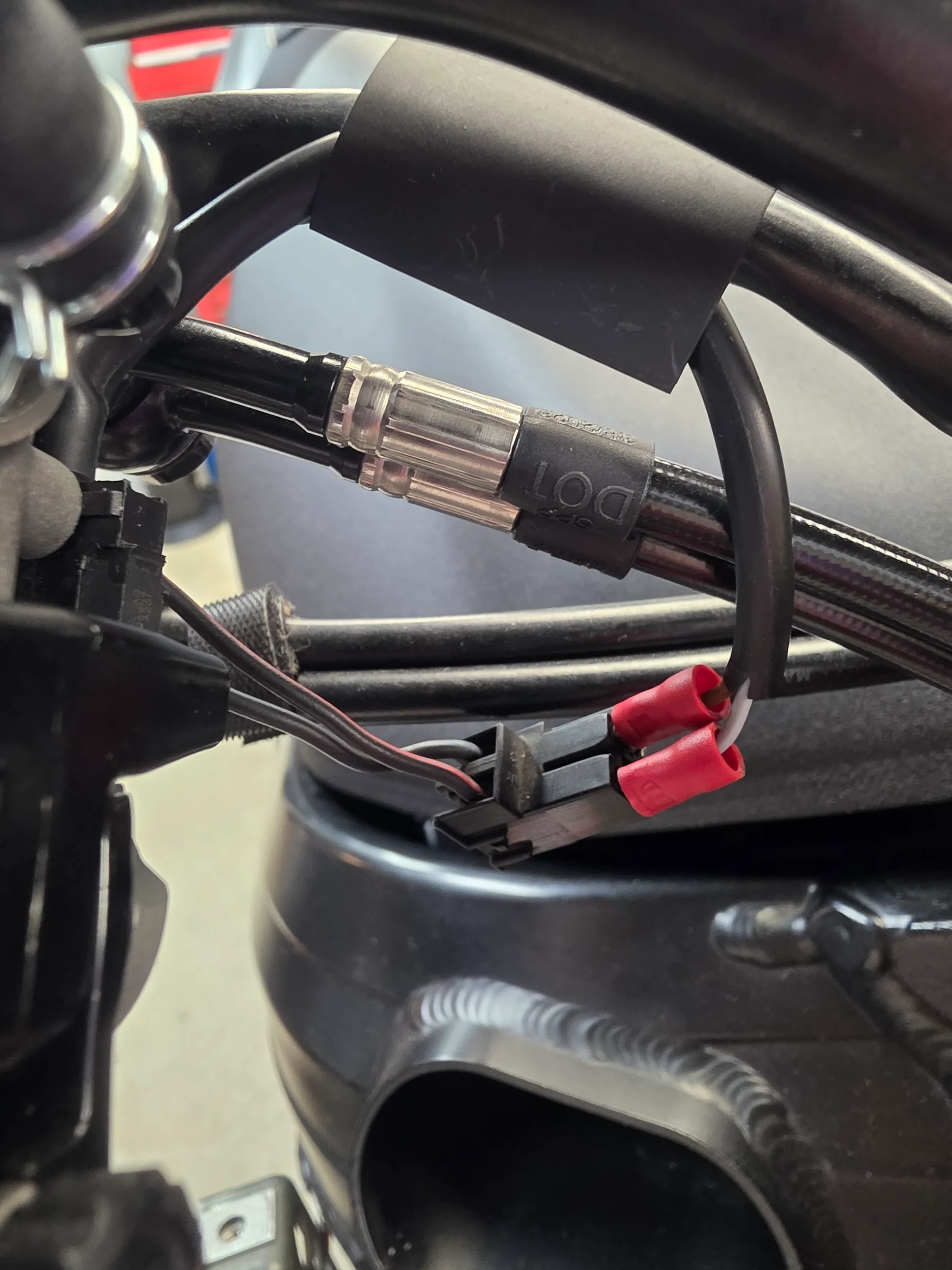

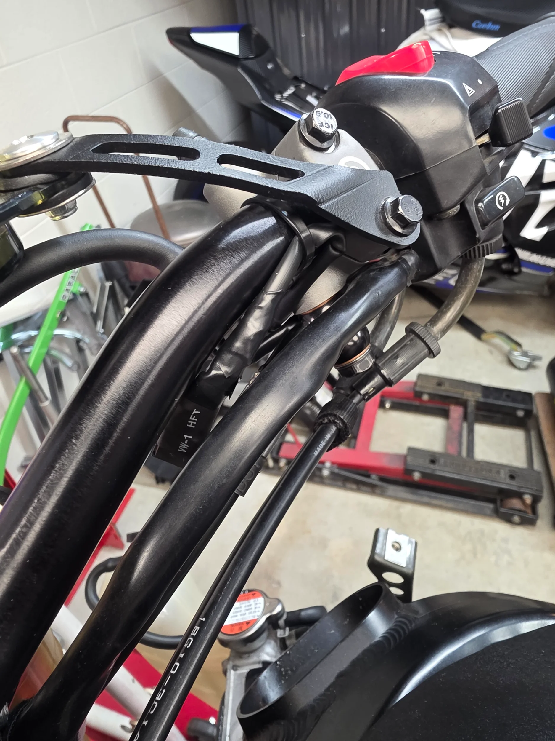

Brembo brake light switch connected to the oem harness and plug, Brembo wires shortend, pins to fit into the oem switch plug crimped on, heat-shrunk, and routed with one zip-tie on the bars...and I have working brake lights on the first try...

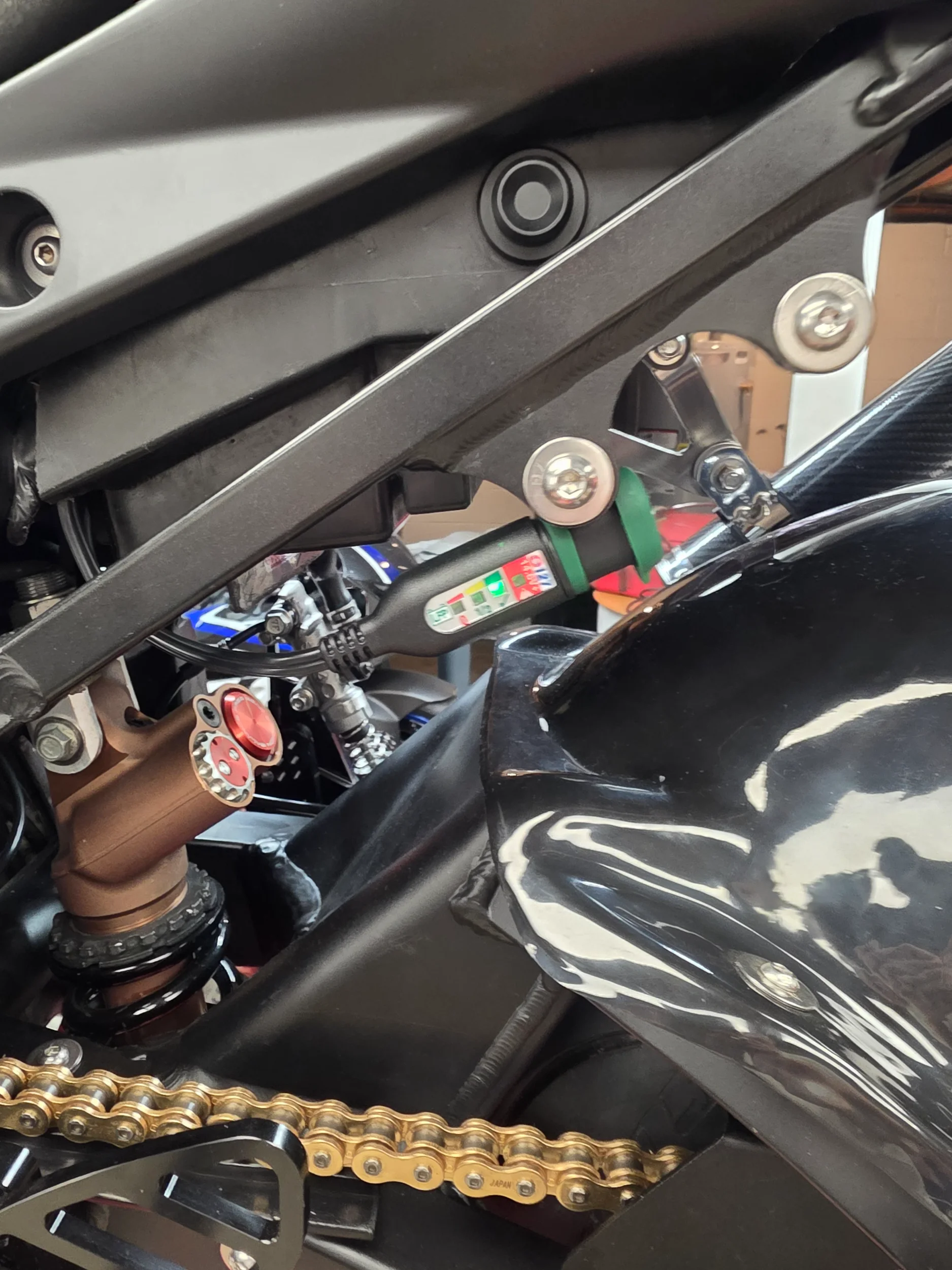

Decided to use a black plactic push-in style plug on the rear passenger peg bolt hole, instead of a bolt that does nothing.
I cut the back of the plastic plug flush with the subframe.

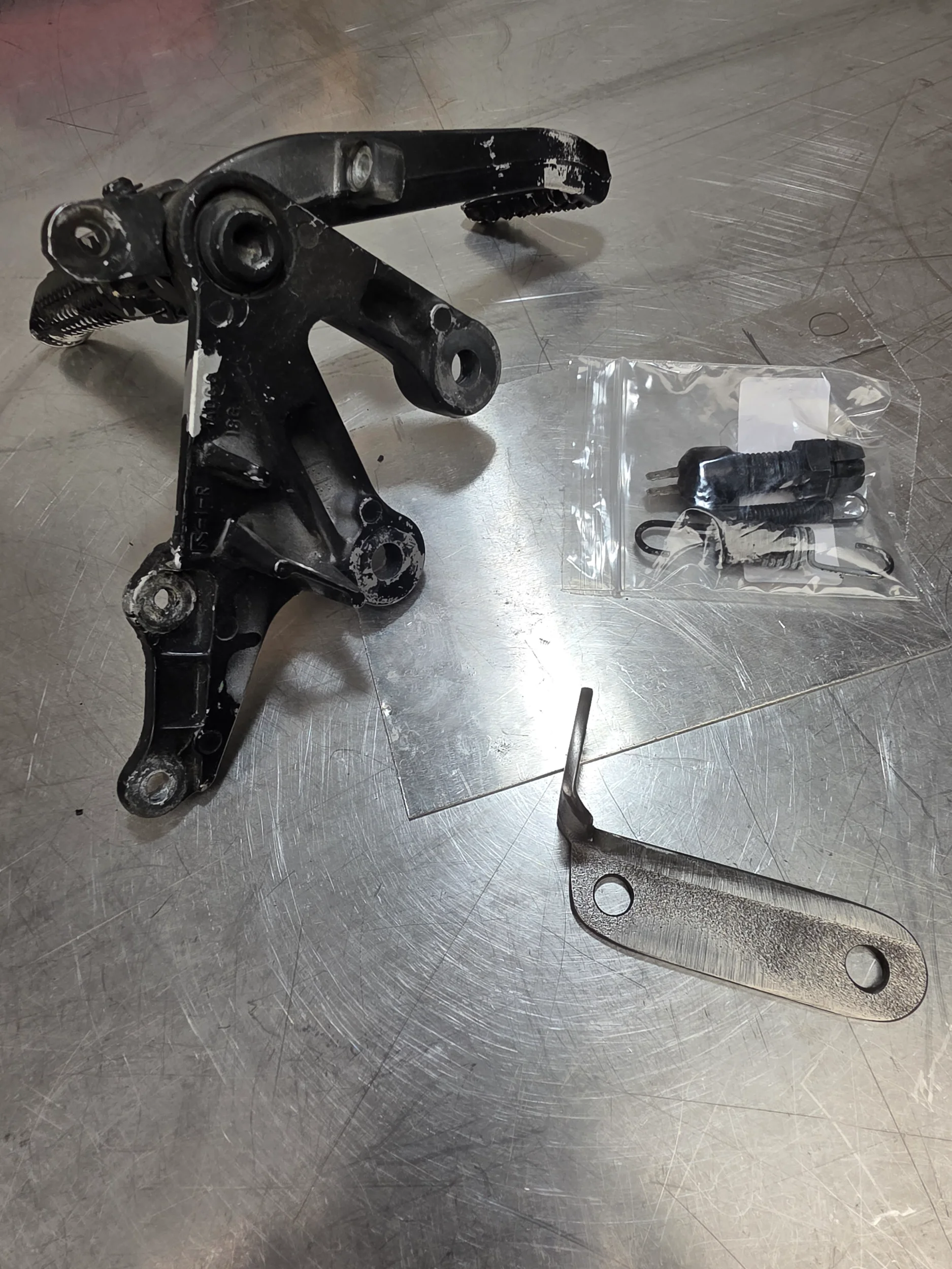

I have some .050" aluminum left, and have to fab a bracket for the rear brake light switch, as Vortex rearsets do not come with any mount for it.
I have a plan, and have one from another project, but that one is the reverse of what I need, and I'll use the back of the stock footpeg bracket as a template.
But, I have working brake lights from the front brakes, so it's not high on the list at the moment.

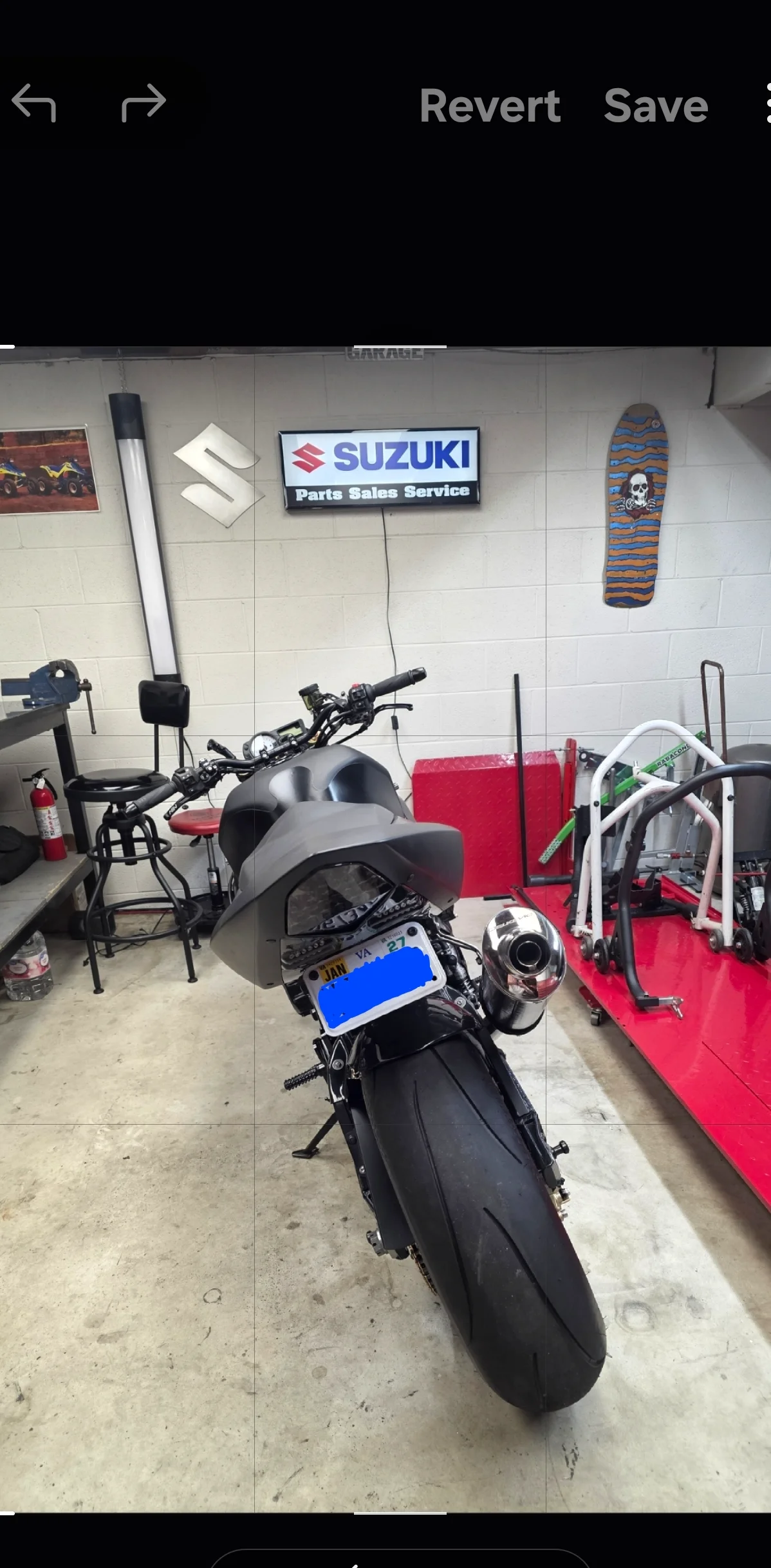

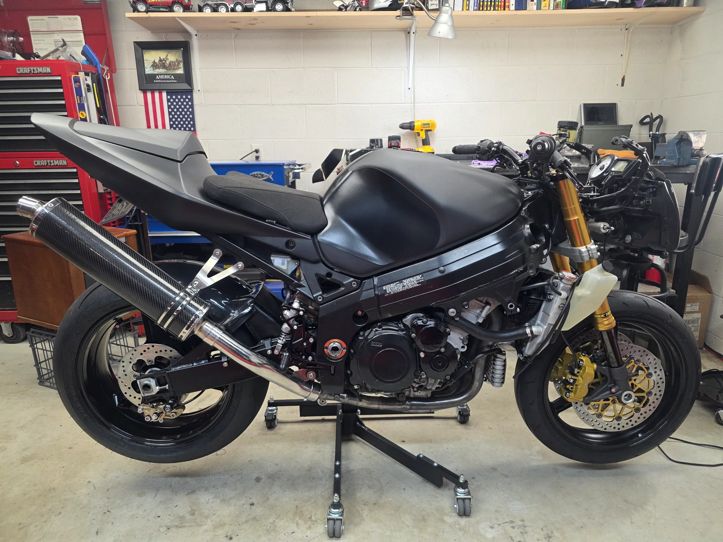

The bike is off the lift table, and hopefully for a while.
I have it on the Constand, which will make adjusting the suspension sag much easier.
I'm going to try out the Motool Slacker for the sag too, might as well...it's only been on the shelf, new in the box, for around 3 years now...
The Constand will also make setting the rear ride height much quicker, as the '21 Showa R shock raises the rear over an inch or more, and the seat height is Tall.
I have Schintz +2/-2" adjustable lower shock links on it.
Check out the kickstand lean...did I say it was Tall, lol
It looks pretty cool without the fairings.....like a modern naked bike....
But we both know the fairings are pretty cool too.......a classic shape.
Well done, the beast looks awesome, I'll bet it will be even better to ride.....
Thank you sir.
I'de like to keep the fairings off of it too, and though about making a new headlight and guage mount, but don't prefer the wind without the fairings after a short ride.
The small nose and windshield make a big difference.
