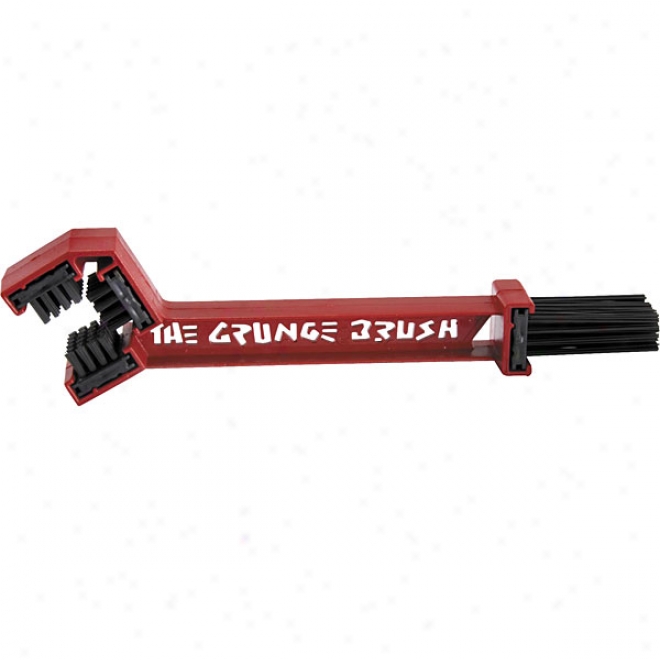

You clean it every 400 miles or lube it?
I use three step process every 400 or so miles.
wash,lube,wax
