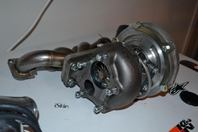

Well I finally pulled the trigger and bought myself a setup. Im going to use this page as my build thread with all the details and pictures of what ive got going on.
So heres a little background on the current direction im going with my build. I compete in an organization in Canada drag racing. Last year I competed in the "street" class, which is an entry level class with any street legal bike as a bracket style class. I did fairly well this year and decided I want to move up a class to superstreet. Since the rules dictate how long the bike can be stretched, the type of clutch I can use, plus no boost control, you will see why im not going "all out on" this build.
So now with the good stuff. The parts heading my way, which should be this week or next week:
RCC Turbo stage 1, with a bigger turbine housing to breathe a bit better,
Blowoff valve
Rcc billet fuel rail and upgraded injectors
Stainless steel valves
Heavy duty valve springs
Wossner 9:1 pistons
Wossner rods
High flow oil gear
Rcc slave support
Cometic head and base gasket
Brocks ultra clutch mod
Heavy duty clutch springs
And last but not least studs to hold it together.
I will probably run 10 to 12lbs of boost with vp16 as fuel.
Currently Im running 9.5" over for a stretch, but have to shorten it to 4" over for the class im going into.
I will be using ECU editor to tune with, and havent decided what im going to be data logging with yet. Either start simple with a wego 3 or an innovate dl-32 and have everything that ill need.
However, my future plans with this bike in the future is to redo it again and set it up for pro street.
Ill upload pics shortly of what ive got done so far tonight or tomorrow.

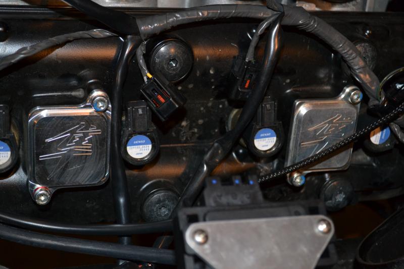

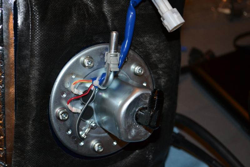

Well, I did a bit more work to the bike this weekend. I am still waiting for my fitting to drop the motor but I did what I could. Installed the oil cooler block off plates. Ditched the pair valve and installed the pair valve block offs. Removed and gutted the stock fuel pump, and prepped the housing for the new one. I also removed the upper throttlebodies. Not much, I know, but like I said after I get the motor out it will be alot more progress...lol.
However, here's some pics for you guys ( I know that's why you're here!!! :laugh:)

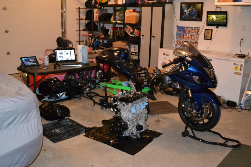

Well I got some more work completed on the busa. I ended up getting the motor dropped and completely ripped the thing apart. I organized everything with plastic bags with labels as I went on, so things are tracked. I didn't get into a situation that I wasn't sure where a piece didn't go or come from. All I used was the shop manual, and I have to agree with what someone else on this board had mentioned, the manual doesn't make mention of the bolt under the crank balancer...grr. I fought with it for around 10 minutes until I saw the little bugger...lol. Other than that, it was pretty straight forward and not that complicated.
Here's some pics of the progress. Yes I'm workin on the floor as both of my tables had been taken up as progress went on, however I have a soft mat underneath, as well as plastic to catch everything.
