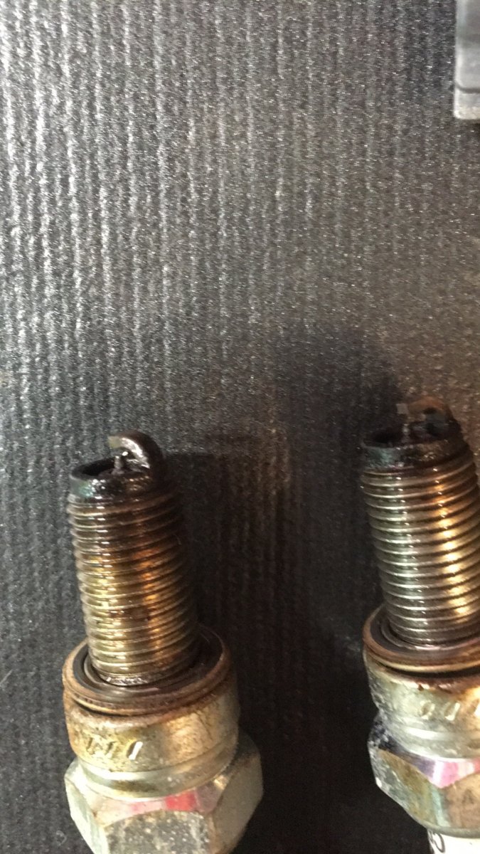

Wouldn't restricted fuel give you a lean condition v. a rich condition ? I would have changed the oil and plugs, went for a good long ride and pulled and checked the plugs, but that's me.
Restricted flow could cause rich condition if the injectors aren't working properly thus causing fuel to not ignite properly.

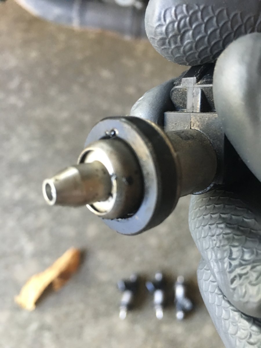

At this point, I think it is a fuel issue. I ordered the fuel strainer and, when that comes in, I will tear the pump down and clean it out. I will be sending the injectors out this week for service. Once they come back, then the new plugs will go in and re-test.

Got the fuel pump back together again with the new strainer tonight. Put it back in and connected everything. New plugs, air filter, oil change, and then.... it started raining. For about3 hours. And, with a new rear tire (hasn't been on the street yet), I figured tonight would not be a good time to test anything out.
It may be because of the new plugs, but it does seem to run better right now. I still need to get the injectors sent out for professional cleaning. Hopefully this weekend.

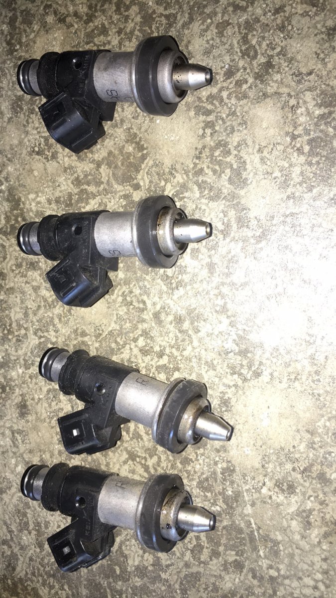

I have a set of gen 2 injectors. I think they are the same as a gen1
300 miles on them oem brand new pulled from my bike if interested

Sent the injectors off this morning. And have a slow HD to keep me company for the week.
