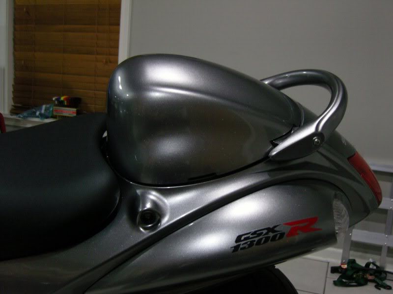

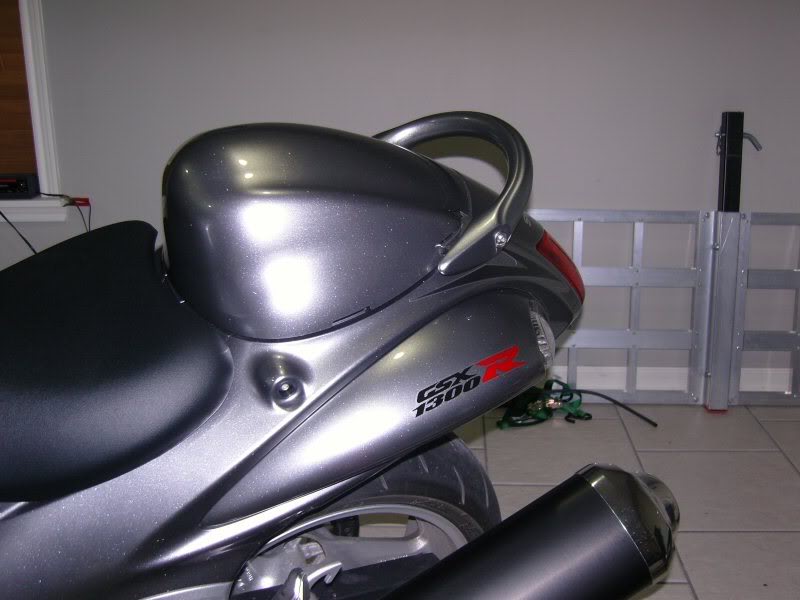

On my Gen1 I just bought some to replace them. This time I went down to the store and got some SS allen heads to replace them. Saved some money, look identical to the other ones and got them the same day :)

The ones from smithabusa (boostbysmith.com) have the shoulder on them that matches the factory franken-bolts. I have those. Just wanna warn you cause I tried the same thing you did back with my Gen 1 and the rear tail cowling cracked where the bolts go in. Let us know how yours hold up.

These look identical to the ones I ran for 4 years on my Gen1 with no issues. I kinda dig them be sunken in (or just use to it, lol), but I'm not worried about cracking. Just like on my Gen1 the bolts don't really hold anything together since they're sunk in, not really sure how it'd end up cracking?

Dunno, I bought my gen 1 used and there's a chance the rear cowling was cracked when I got it and the Frankenbolts just made it worse? I don't remember at this point, but if it works out for you :thumbsup:

I am guessing that the vibration over time may have done it had a friends crack when he did his but is there is no movement or wiggling after your swap I would say you in the clear :thumbsup: .. looks good to me, hope all goes well I am sure plenty have removed those monster bolts an put regular bolts without issues:thumbsup:

Only problem is if they don't have the lip they aren't holding anything. So essentially you could leave them out and serve the same purpose... :laugh:

Yep you're definitely correct sir. It did cross my mind, though already bought them and didn't want to look like they're missing :)
Anyone got a pic they want to share of what they look like with a shoulder? I'm debating going the washer route or just adding smaller ones so my bolts aren't so sunken in looking. I guess I never noticed it much on the 03 with a silver tail, but this tail is darker and stands out more.
