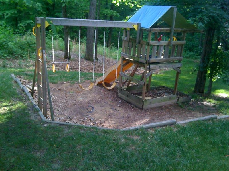

Ok, here are the pics. Playset from my back deck. Note it's location near the trees and the ditch where the water runs. I don't see how the tank could be this far out. The other two holes I've dug are dry the holes are for a 10x12 square which will basically sit in the same spot. The only outside spot I can see that might be the sewer line is in the bottom patio. Last pic is standing on that cap in a direct line to the playset.
I've never seen anything in the yard to tell me where the tank is. The water level in the hole is only about 2 inches deep, and that's not changed any since yesterday (showers, toilets, etc.).
My question is, if that's the field side, why couldn't I just pour a little gravel and some quickcrete into the hole and let it set up, wouldn't that seal it?
Thanks!

And guess what, here is the septic layout I just found it....I'm on the field somewhere....gotta be near the end of one of the field lines....

Ah ha, "Large Diameter Gravelless Pipe"; explains why i didn't hit gravel!
