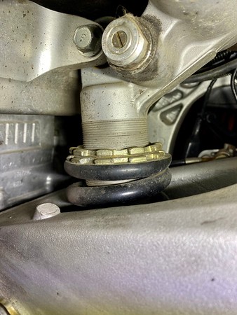

Alrighty. We have:
+/- 3.5 mm from the clamp to the top surface of the cap.
+/- 6 3/4 turns counterclockwise on the brass adjusters (spring preload?). And 2 clicks out CC on the inner adjusters (compression damping?).
Out back, on the top we are at 9 clicks out (compression?).
At the bottom (rebound?), we are 6 clicks out from lightly bottomed.
Rear spring pre-load looks like this. And I ordered the magic sag stick.
I may start an Excel sheet to track my changes...

Those settings aren't good for your weight. There is also no exact place they should be, you'll have to find it(other than the fork height in the triple clamps).
And unless that rear shock is completely worn out...it has got to be a hard and bumpy ride with that much preload.

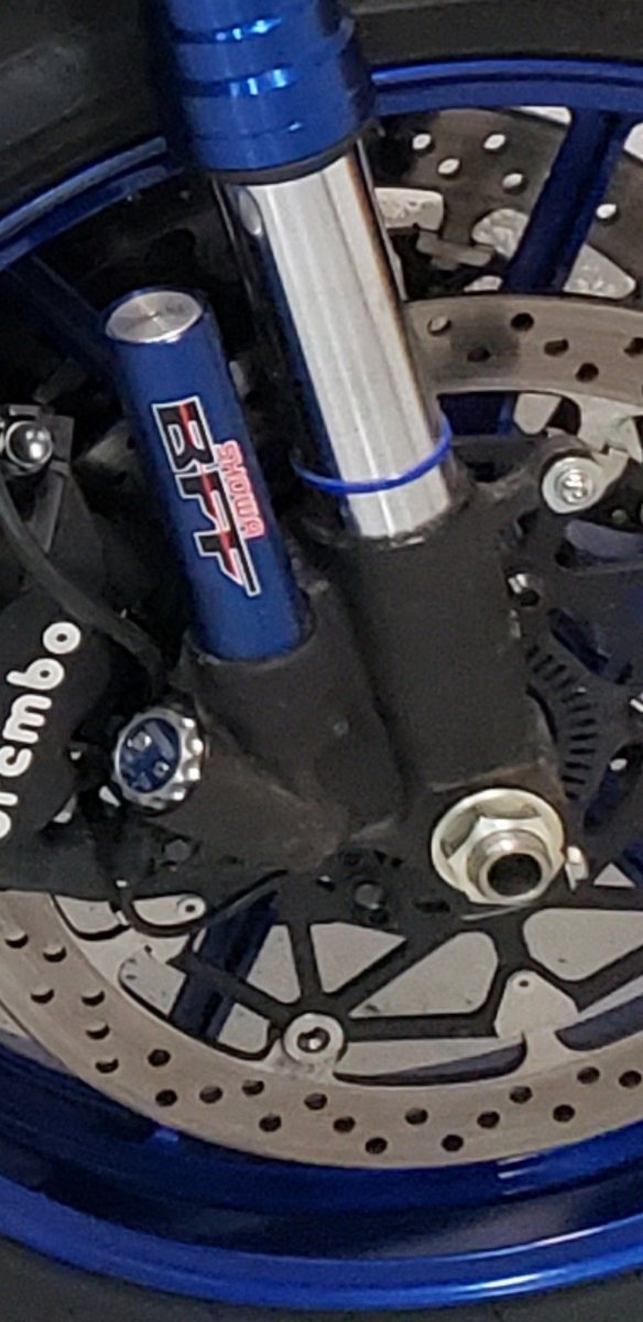

Basically, break your suspension into 3rds.
You want the top 3rd of travel to 'sag' under your weight when you sit on it.
The middle 3rd to be where it does most of it's work.
And the bottom 3rd as your 'over rev' or excess travel, for hard bumps and potholes.
The zip-tie around the fork leg is a great trick too, as it lets you see if or how close to bottoming out it really is.
Yep matching blue zip-ties, I like any color bike as long as it's black, my buddy likes blue, so I cut off the black ones I had on there and put blue ones on for him(hey, I ride for Free, so...lmao)
They also sit a little higher than where they are in the picture, they got moved while the wheel was off.
