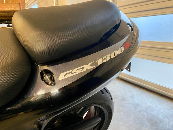

Any recommendations on a stock-appearing Gen 1 passenger rear grab bar?

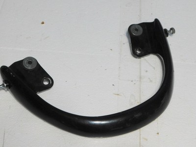

Oh look, Suzuki offered one... Do I need to mod the hump for these?

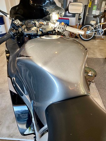

Do those front, tank-mount, bars work well? This actually looks like a terrific functional solution even if the aesthetics aren't my thing.
hump needs modded/cut with dremel, about the same cut-out you see under the lower rear of that passenger seat, if you want to have the hump And the bar together

I just noticed that the bike has HeliBars on it. Probably perfect for my intended use. Would these contribute to vibration putting my throttle hand to sleep after an hour? Or is this typical of the breed?
33,015
56,179
The vibration is a typical fault of the bike...
33,015
56,179
I put gel grips on mine and changed out my gloves to ones with a heavier palm...my right hand still gets buzzed to sleep sometimes..
It seems it is the nature of the beast....almost every Suzuki I had suffered from the same ailment....
