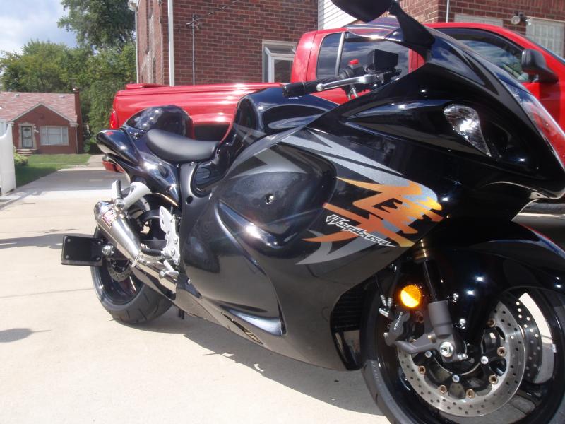

I need to play with the tuning on it now, but the system was very easy to install and download a map to it.I do like how you don't have to have the key on or bike running nor the 9V battery anymore.Only one day and all I can say is better hold on when you twist it.. Yes, milage takes a dump from 43 to 29, but I didn't buy it to save gas...I need to play with the tuning on it now, but the system was very easy to install and download a map to it.
You need to make another hole for another 02 bung..I got the Auto tune for my 09 Busa and the sensor doesn't fit in the exhaust. Is there and adapter or do I have to make another hole in the exhaust for the auto tune sensor to fit?? I got the PCV with the switch and the yosh R-55 full exhaust
