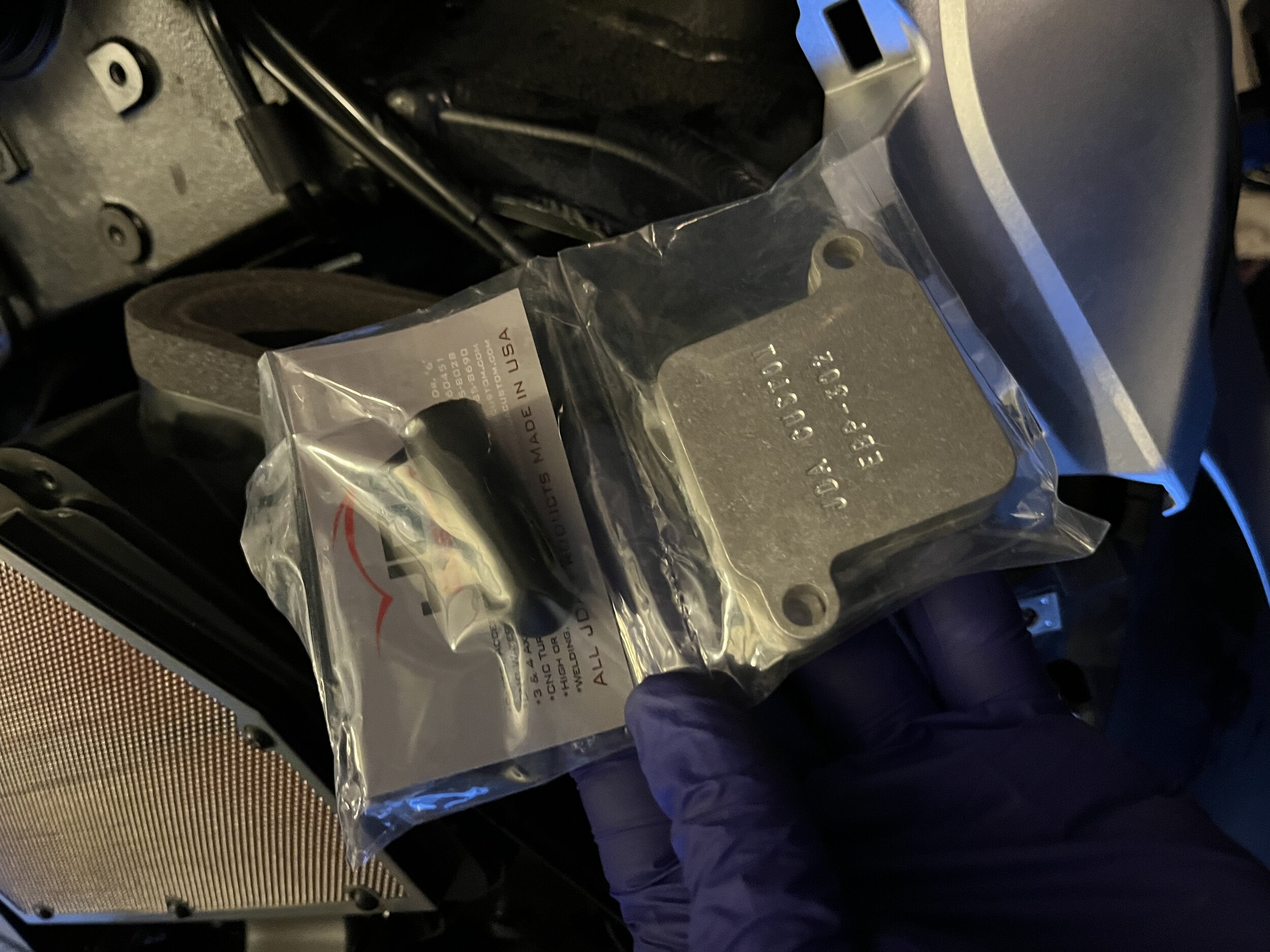

Looking at the block off plates for the pair valve and the plug in resistor to stop the light from coming on.
I know about the marble mod but it bugs me to have parts on the bike that are disconnected and doing nothing so I would rather remove the valve.
How difficult are the plates to install? Lots of stuff need to be removed for access?
Since my pair valve is turned off in the tune would I even need the resistor?

The install is easy-peasy....
Tank lifts up, air box comes off and the PAIR caps are exposed on top of the valve cover....take them off and install the plates....then install the resistor plug cap and take the pair system off....
As you have the tune to shut off the PAIR, you probably don't need the resistor plug but you have it and connecting it won't hurt anything...

Cool. So the only other thing I need is a cap to block the hole in the airbox where the hose goes? Is there just the one hose?

the kit should have a vacuum plug to block off the air box. the whole “octopus” assembly can be left in place or removed all together. its slides off a bracket bolted to the frame. if u decide to remove the octopus u can also remove the mounting bracket. a ratchet wrench will make that easier. with my kit you still use the factory reed assembly since it has the rubber seal built into it. i just removed the reeds/ hardware from them.
