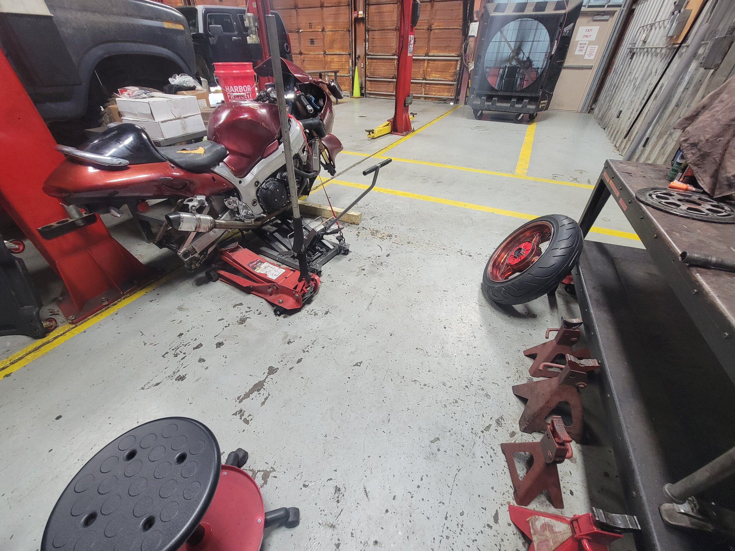

Thanks for the replies thus far! Injectors will be the next move. It is an 05 and has 28,xxx miles on it. As far as the fan kicking on and temps go, I can't say. I don't recall the fan kicking on and I believe the temp gauge isn't operable. Once injectors are done and the bike runs I'll be able to get a more definitive answer. Until then, we'll leave that to simmer. Here are some photos of the project as it progresses....
Those twist caps are what I lifted the fuel tank to see. They are no longer apart of the fuel pump's ecosystem.

Welcome to the .org! Looking at the pics, I would add the flushing of the radiator to everything that @Bumblebee and @sixpack577 posted. A bit concerned at your statement regarding the need for an alignment. What needs an alignment? If you are referring to the frame, that makes this a much more complicated endeavor.

Nothing frame related, thankfully. Coolant flush was performed with distilled water and it's running the blue stuff now. The old front tire looked slightly out of line with the handlebars, but that seems to have resolved itself with the new tire/wheel that was put on. Maybe my vision was a little more crooked then.
To answer a question I missed earlier, if I had to guess it had sat for a couple years at the minimum.
