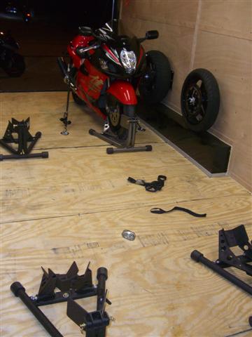

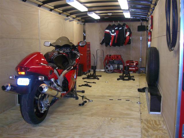

i finally got my trailer and this dealership included the V-nose length so to them this is my 6X14 V-nose

Thx i found the thread, but my main consern was the walls are pretty thin and didnt know what length screws to use or if it takes a special kind to hold the weight
You will want to try to fasten them to the metal support members. Looks like 1/4" luan plywood...and I'm guessing 1" metal supports...so a 3/4" sheet metal screw should work.
You can also get a hardwood board (2x4 or 1x something) and fasten that to the metal supports...then you can use regular wood screws where ever you need 'em. (that's what I did)
If I remember when I get home, I'll take a pic of what I did in my trailer and post 'em up...

Nice trailer. I mounted my Baxley chocks with metal plates I made and installed flush to the floor so I can move the chocks around or to remove them.
