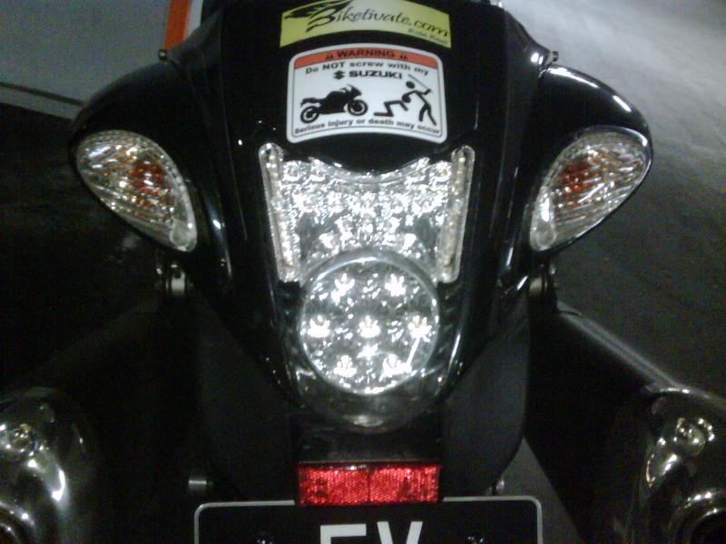

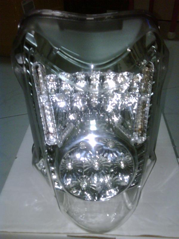

Had installed this integrated led clear tail light on my bike.

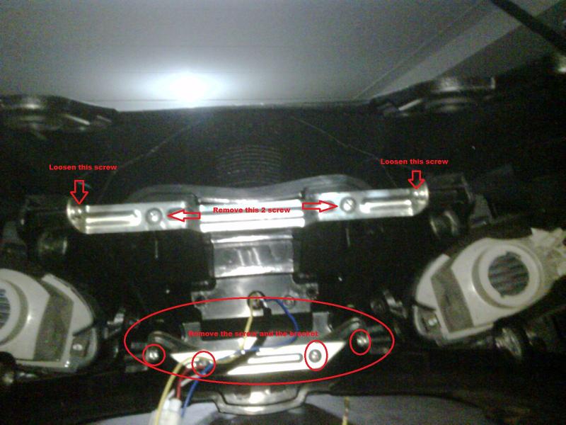

I had took one picture of how to take out the tail light.

I left the signal unhook as it is illegal in singapore to have the integrated signal light in side tail light.

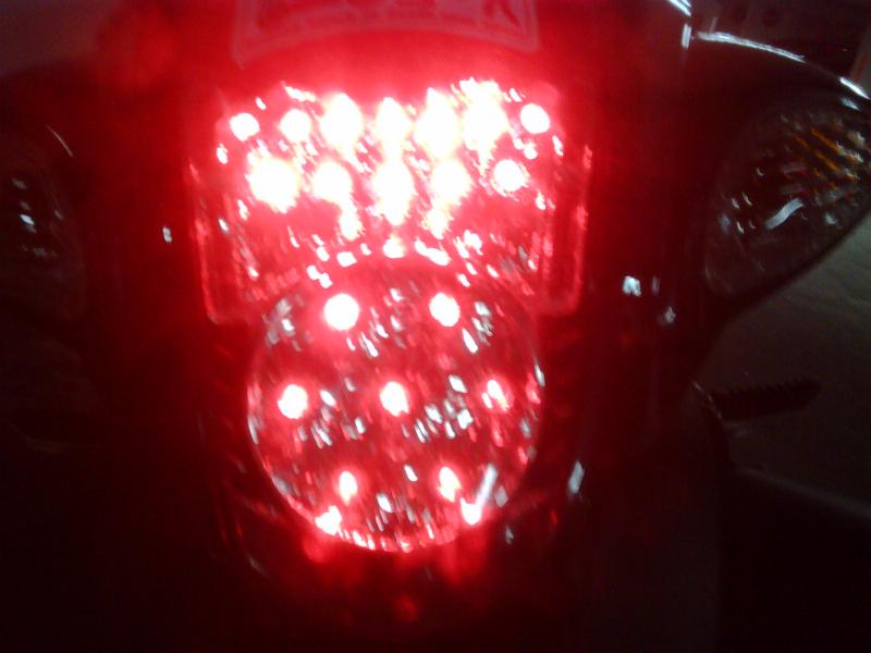

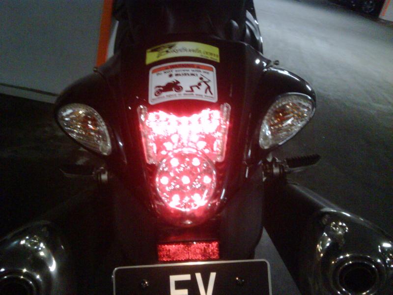

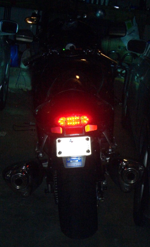

Don't mean to hijack the thread, but I just got through putting on Gen I clear integrated lights, thought I'd add some pics:
Very nice, I have the same one on my 08. I also hookes the turn singles up in the light along with the stock ones.
Cool, for anybody who's interested, the Gen I cost $33 including shipping (which took forever from China) off eBay. It included the correct plug for the busa's running/brake lights but required splicing into the blinker lines which I did with a small 2 pin plug. I had front LED blinkers already so I already had an LED flasher unit installed, without this, I'm sure your blinkers will flash very quickly.
The light includes a row of white LEDs for license plate illumination and the outer edges change from red to amber when the blinker is used. I tried but couldn't capture the blinker with a picture, just take my word for it that the amber it quite noticeable from the red.
As you may be able to tell from the pictures, I have also changed to custom cut 3M Diamond reflective sheet instead of the ungainly round red reflectors that come on the bike. That plus the removal of the blinker stalks gives the rear a much smoother/cleaner shape.:thumbsup:
