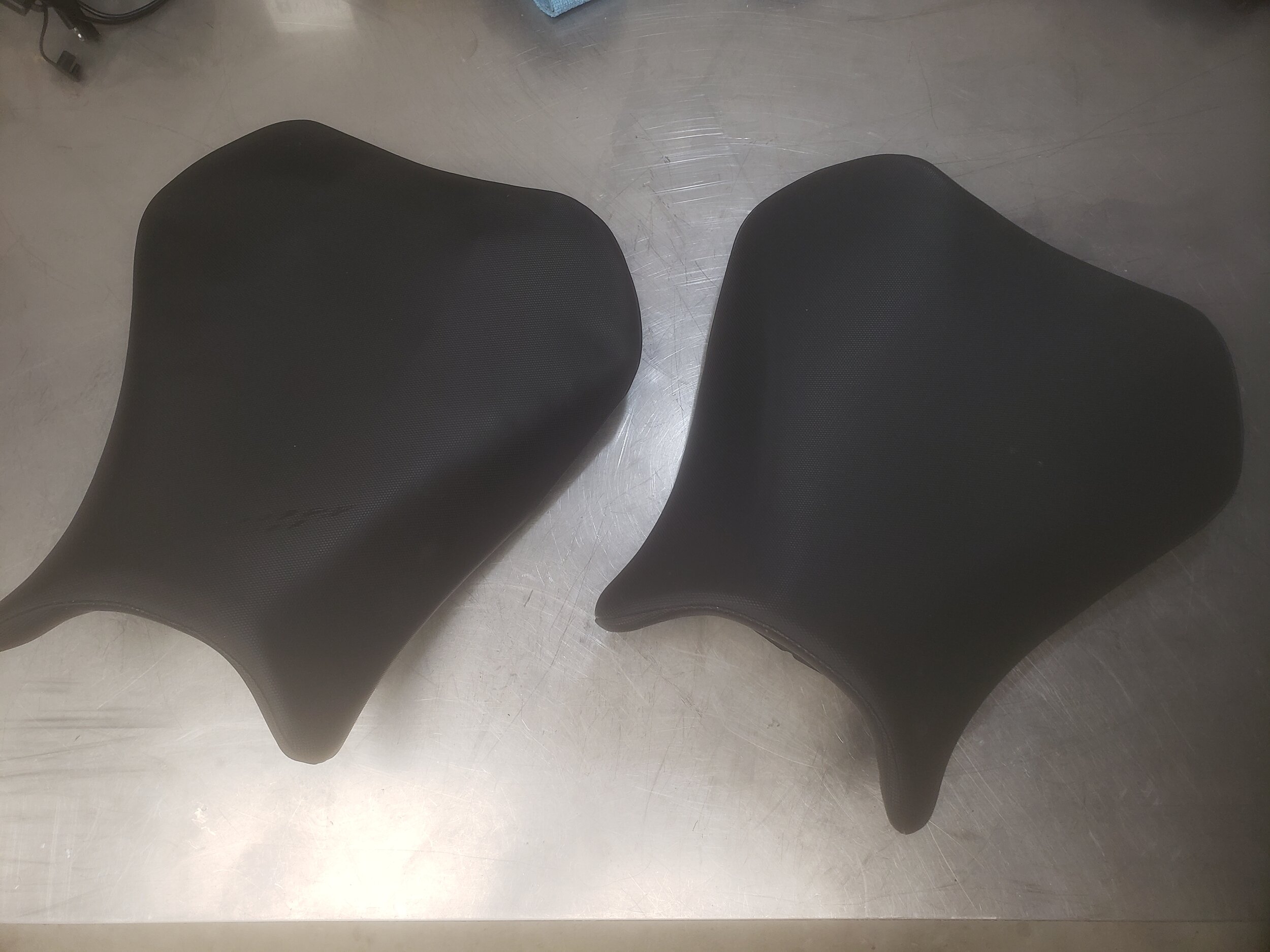

I bought another oem seat for the '18 Gsxr1k on ebay for $60
It literally took me 3 minutes to pull out all of the staples.
The cover pulls right off.
The seat foam may or may not be glued to the seat pan, and it really makes no difference.
In this case, the foam is Not glued to the pan.
Next, I measure and mark the lines.
I already know what I want, but I made multiple lines before choosing the exact ones to cut on.
I marked those lines with a black Sharpie.
I then cut the 4 corners with a razor, to make an opening to get the electric knife in. But again, you can cut it all with a razor if you choose, it can just take longer.
I also cut all the way through, and will be using part of that cut out foam to make a bottom out of, instead of just bare seat pan.
I also cut the seat more level, vs it's previous upward rear curve.
The sides are still a little rough, as I'm not done yet.
You can also see that foam in the center is just stuck in place for now.
I only put about half of the staples back too. Enough to hold the cover in place for now, but it will come back off
The reason being, this seat feels very good with a test sit, but I need to put some miles on it, and see if or what adjustments I may want to make.
You really have to try hard to mess this up, just remove small amounts of foam at a time, but you can always glue it back.
I have a big block of medium density seat foam for adding pieces for shape or height, and I will make a new, thin, top layer of foam for the final seat.

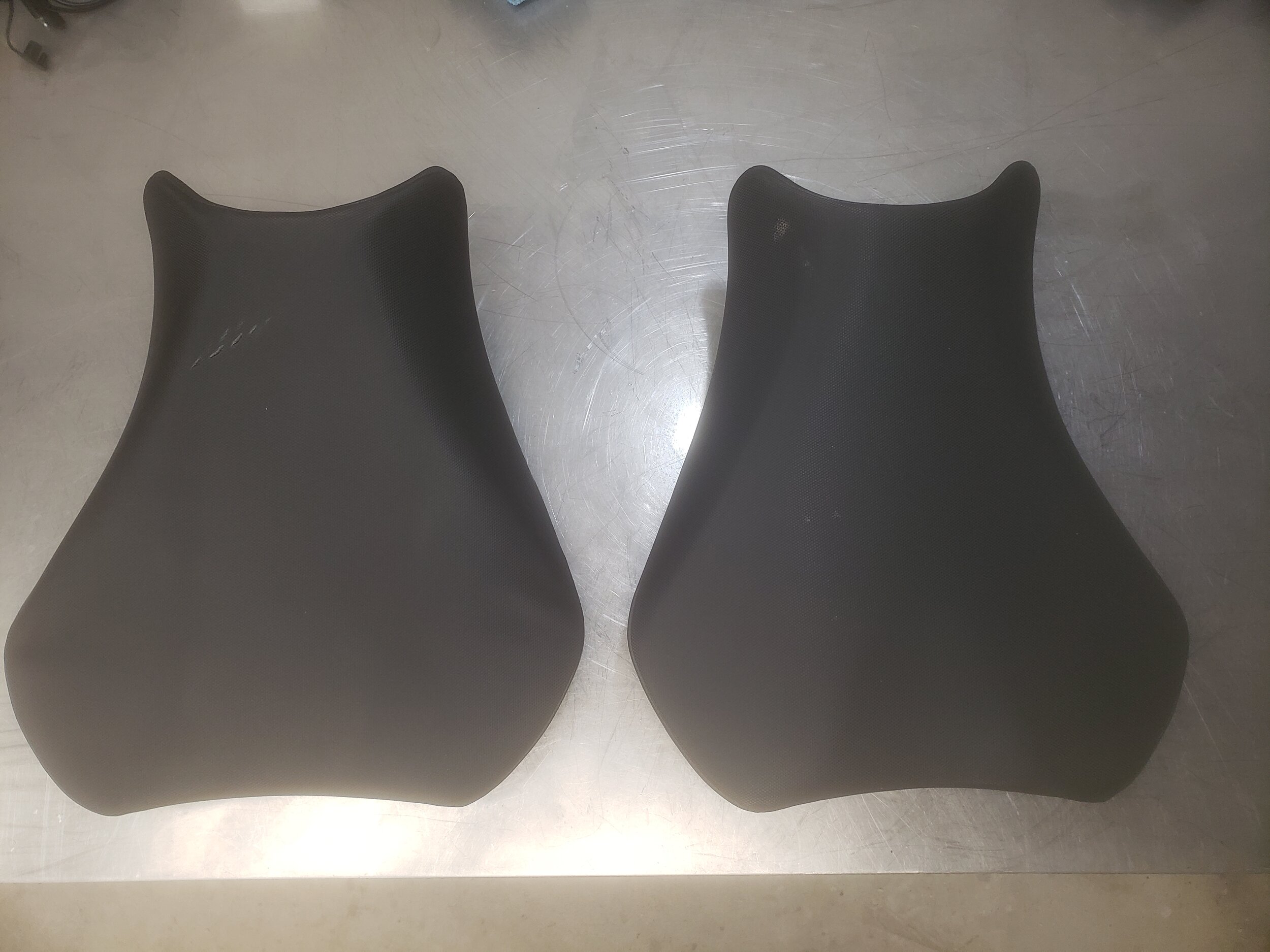

The seat feels great, but needs to be taller.
This what I expected anyway, as I cut the seat flatter, so the height at the rear was lost, but now I no longer slide forward.
The height is any easy fix.
I can cut off a piece of a foam block I have.
Or, use several other materials.
If you've ever been in an uphosterly shop, you know there is alot to choose from, and several for the seat top(under the cover).
For this, I am going to use one or two of these, as I have on other seats...carpet foam samples, lol.
These are so old that they are made in 'Murica, of the finest poisons no longer available...the result is a piece of closed cell foam on one side, glued to/made with open cell on the other side, with medium density, that cuts with scissors, glues to the top of the foam, and it Never deteriorates, lol.
(The stock seat foam is open cell only)
These are better quality than some of the expensive seat materials that I've looked at...and I got over a dozen free at hardware store over a decade ago...and they are still in the same condition as then, when they were probably 20 or 30 years old , lmao.
I will simply cut a piece to match the shape of the top of the seat, then cut the edges with a slant, so it blends in under the cover.
This piece will also not have anything cut out in the center either, as there is no need anyway.
A cutout would only give a place for the glue to seperate from the seat foam to the foam seat top, which could result in uncomfortable and visible lines.
And, speaking of which, with no cutout in the top foam, and the edges blended in, any side or center cutout lines visible through the seat cover, become amlost if not invisible.
There is still no pressure between your legs with the top foam covering the seat foam groove, as the top foam is only stretched over that opening in the seat foam, so the effect remains.

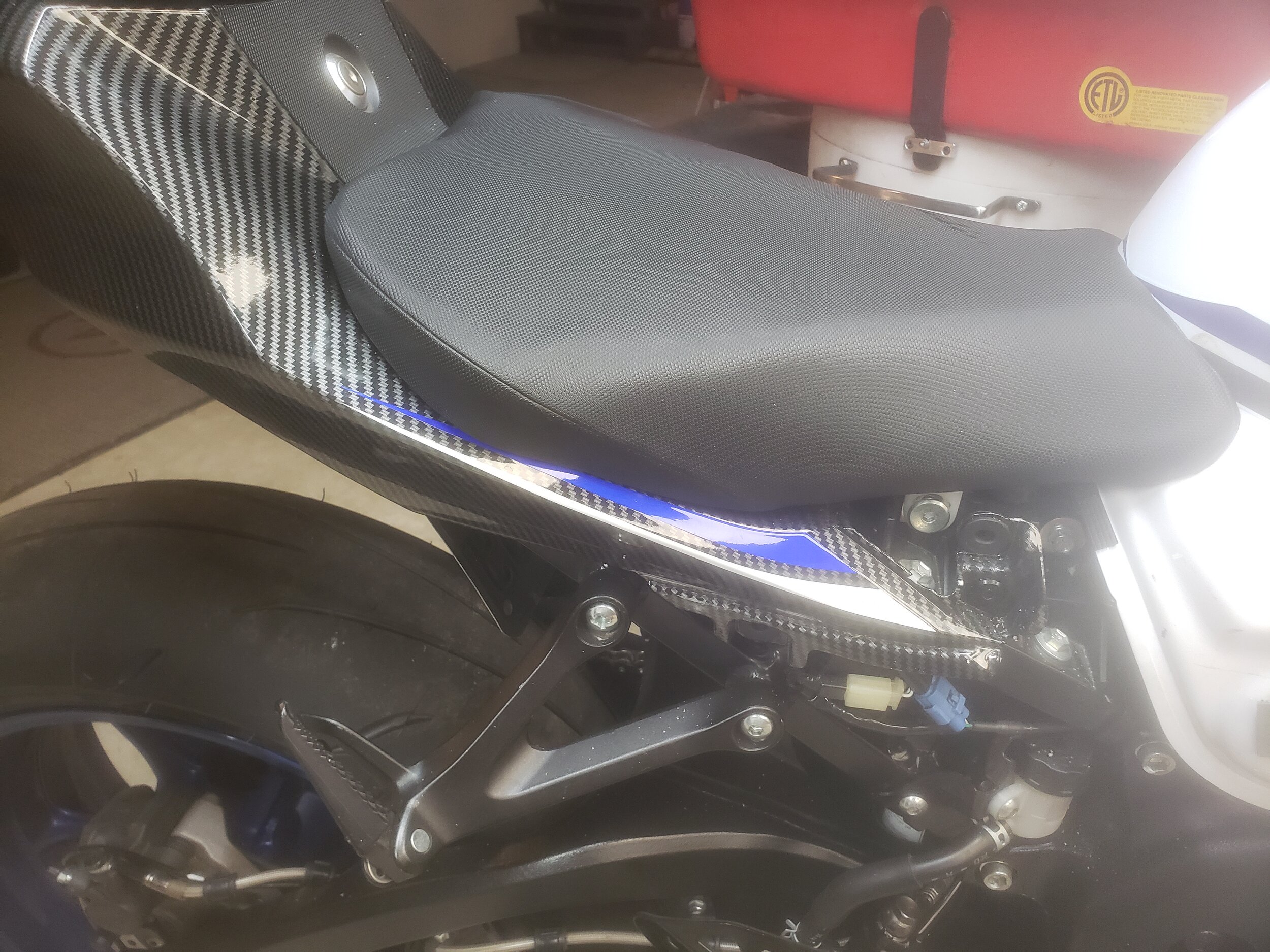

I'll post pictures after, I hope to get it done tonight.
I finished the seat top last night, and the test sit is good. I measured and cut a template, cut out the foam, then cut it's edge on an angle so it will blend into the seat.
Now, a few staples to tack it, and a test ride over the weekend.
Assuming it still feels good, then finish stapling it, and it's done.
