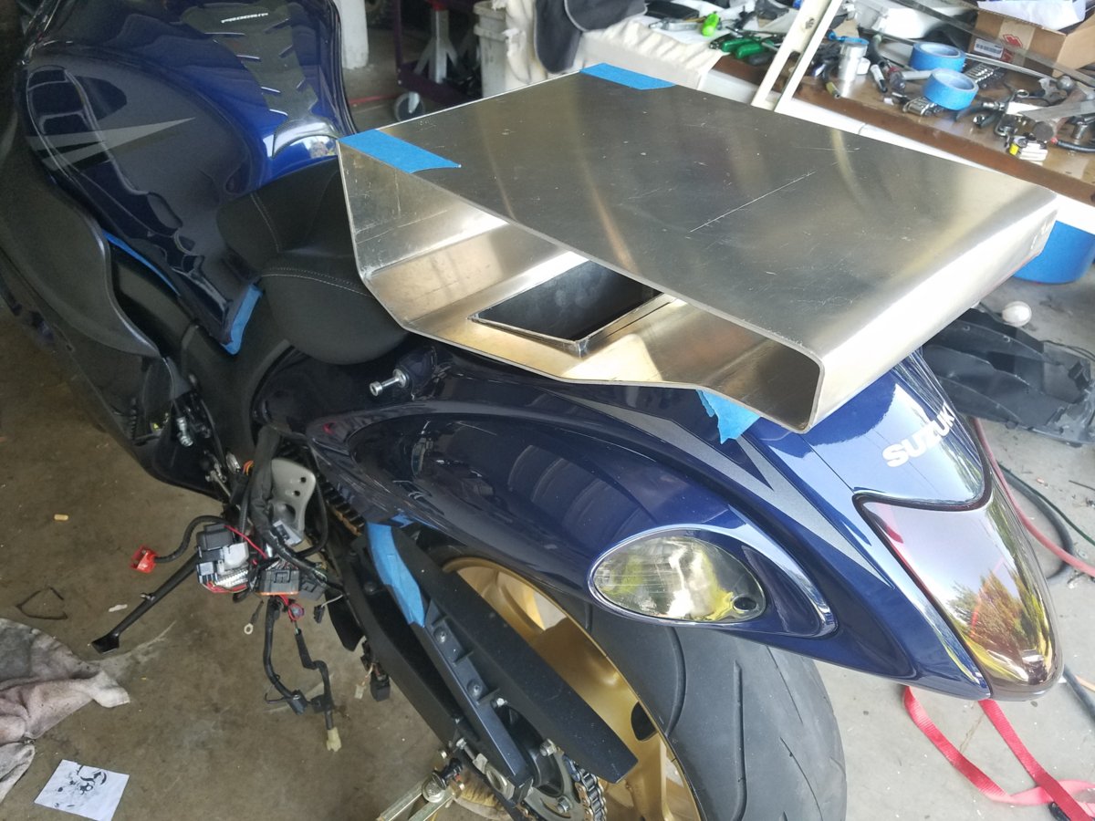

I have spent years on this site reading posts and researching everything from Tires to Aux fuel tanks and everything in between but yet I have done so silently without posting anything. I figure its about time I post some pics of the bike I have spent the past few years working on. The goal was to build a potent and competitive endurance bike that is not only functional but clean and custom.... oh yeah on a Busa platform! Here is where I'm at so far.

Thanks! Most of the bolt on stuff is pretty standard Busa upgrades. Except for the tank and the headlight, those were endless hours of fabrication. Especially that fuel tank, I wanted to carry extra fuel so I looked into everything from MSR bottles to big red gas cans. In the end I decided to go full retard and build the most custom and functional iron butt compliant tank I could come up with for a Busa.

Amazing work! I was wondering how you could fit so much gas in such small tank. :-)!! Now I see way. This takes the "trash can mod" to a whole new level.
Excellent workmanship.

As far as the tank, the goal was to carry 11.5 total gallons as low and forward as I could get and keep as much of the Busa aerodynamics and style as possible. I used up every possible square inch of space for fuel from the rear tail light to the battery. I ended up moving the ECM, rerouting the wiring and pretty much re-engineering the bike rear of the battery.
