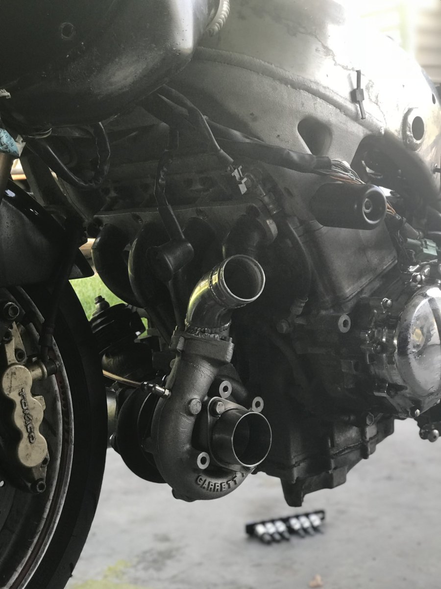

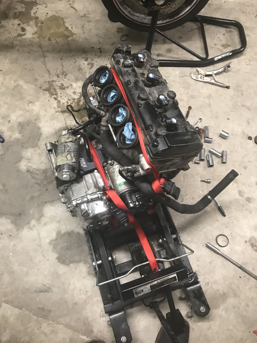

Is was told that this was a JE gen1 turbo piston, but I can’t match the numbers up any where on JE website! Any help would be appreciated!!
No I’m not buying them one at a time! I picked up a set used for a great price lol! I just couldn’t cross reference any of the numbers on JE website!! I was able to get in contact with JE and they answered my questions! There 8:7.1 compression and require a .080 spacer plate!!
Damn 8.7 and a base spacer... your compression ratio is going to be like zero point zero
