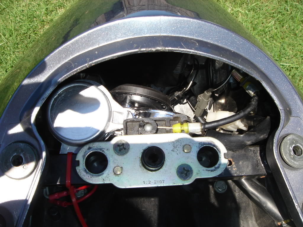

I installed my Stebel horn today. My observations are:
1) Why do they send you a nut and bolt for this thing when you have to drill out the hole to make it large enough for the bolt?
2) I mounted it in the stock horn location, I am very concerned about the clearance to the fender. See the pics but it is about 1.5 inches from the fender. Anybody have pics of an alternate location?
3) It's REALLY loud and authoritative - sounds like a Ferrari horn.
4) I modified the stock bracket by sawing off the original mounting hold and then bending the tip 90 degrees - again see the pics to follow.
Anybody have a suggestion on loading a .wav file? It's 1568 Kb and compares the stock horn to this one

the head of the bolt goes on the horn side, it holds itself so you can torque the thing down (make sure you torque to spec!!)
Clearance: yes it will hit the fender.. I did not really find a good alternate that did not expose the horn to excessive heat. I think this damage occurred at the Gap during spring bash and pushing the bike pretty hard... did not even see it until I tore the bike down for new front suspension... I think the new 1.1 springs will pretty much fix this I hope..
That would explain why I had to bend the bracket, I didn't figure that out. I drilled out the hole and instead of putting in the head of the bolt, I put the nut there..
I'll have to look at that.
