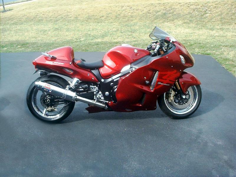

I extended the swing arm on my bike about 6-7 inches, and it kicked the tail end of the bike up in the air. The picture posted is the bike after installing a pair of Soupy's Lowering links. My goal was to lower the bike back down to stock height, but I believe I'm a little lower than stock.
BMW5
