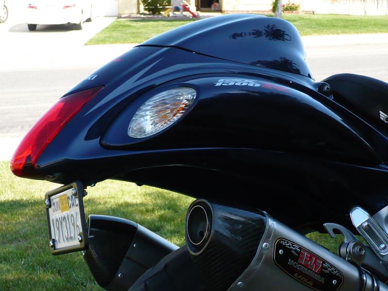

Here's a couple of pics. Sorry, they're dark. But you can get the general idea. I recommend installing this with a plastic screwdriver--or similar. Lay the undertail up along the fender bottom, and use the screwdriver (plastic) to seat it...kind of like seating the bead of a tire on a rim as you go around the perimeter, if you can envision what I mean. The holes line up well enough. For the record, I did a web search on this. It sounds to me as if some people install their hotbodies on the 'exterior'--like I did at first, and as if some do the same model on the 'interior' like I finally wound up doing. But it goes 'inside'. Vast difference in the look.

I don't get what looks different? I took the crazy stock plate holder off (man, what country has plates that big? you could sell ad space on the thing) and it looks no different than the Hardbody thing. I'll see if I can add an LED and aim it away from the Kanji, oops, I don't have a Knanji under the tail.
That's what I'm missing!

I started out wanting to rid myself of the 'shovel' thing holding the plate. Truth is, I'd have been as happy with another type of fender-eliminator. This one's a little more 'slick' than the stock undertail. About the only difference. And yeah, add that LED--and aim it at the filth your tire has dredged up off the pavement and deposited on the front-end of the swingarm--and you got what I got. But no, there's no thunderous difference between this, and stock. It's more of a subtle difference that most people probably won't even notice...
