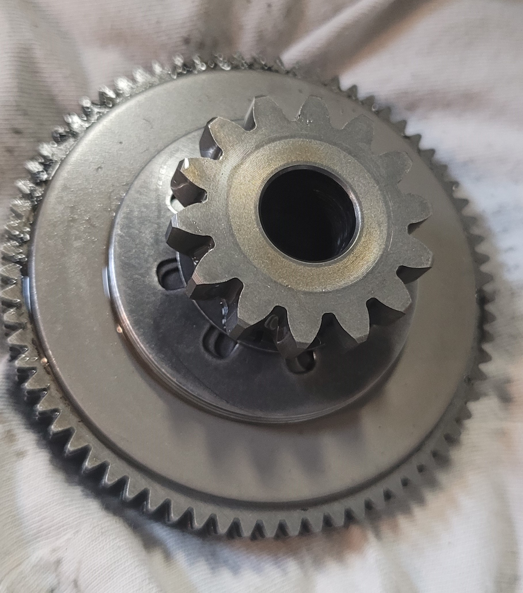

..didnt i read somewhere else on this forum that its nothing to do with compression and whatever else, its a clutch in the starter which is slipping? swear i some someone post pics of this

hm. interesting but at the least, that wasn't the thread i was thinking of as pics of parts in the starter were posted.
time to start digging i guess, since now it'll bug me haha

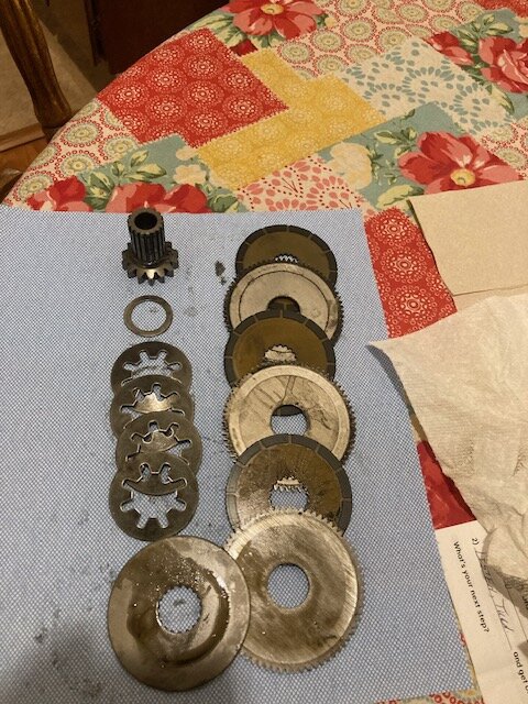

@pashnit is the one that posted about the issue and pics of what he replaced on post #2 of his “2024 pashnit touring on a hayabusa” thread.

These are just my opinions since we the owners can't seem to cohesively agree but my opinion based on my personal experience is the Gen3 has two separate hot start issues. Caveat my two Gen2s and my Gen1 had zero hot start issues over 200,000 miles of riding i put on those three bikes. Something with this motor is different than the previous Gens. We all know Suzuki made 100+ changes and improvements to the internals of the Gen3 Hayabusa motor. One of those changes had to have some unintended consequences. It's the only rational explanation you can come to that explains the Gen 3 Hot Start Issue when all the previous years did not have this issue. This motor has been in use since 1999. It's almost 2025! It doesn't make sense that our bulletproof motor with millions of issue-free miles put on by Hayabusa owners around the world suddenly has a somewhat universal problem with Gen3 owners round the world that affects the vast majority - but not all - of Gen3 motors.
The dying cat sound you hear in this vid clip is exactly what my Gen3 sounded like.
It started at about 7000 miles being intermittent <some brand new owners have reported this happening to them on the way home from the dealer>, then got steadily worse until it would not start anytime the bike was hot. Cold, starts perfect. I push started my <brand new> Gen3 for five months. I don't commute, I only ride the bike on 1000-mile weekend rides, which means stopping multiple times per day for fuel stops and kicking tires. My style of all-day riding also likely make my Gen3 most susceptible to this issue. Every midday stop, the Gen3 would not start <cue video below> and I push started the bike & it started with the least bit of <human powered> effort.
The fix to my issue (& the one in the video) is the Starter Clutch Assembly is slipping (remember it's brand new - explain that.), Replace that and issue solved, right?! Nope, the Gen3 has two Hot Start Issues. Replacing the Starter Clutch Assembly (i simply ordered the OEM part from Rezilla). My Gen3 still has Hot Start Issue after replacing the Stater Clutch Assembly, but this second issue is mentioned in the Gen3 Manual that comes with the bike (Page 2-84). Crack the throttle about a quarter turn and then hit the starter. Bike fires right up. If I forget to crack the throttle, the bike will not start (when hot) and cranks slowly over- even after replacing the Starter Clutch Assembly.
