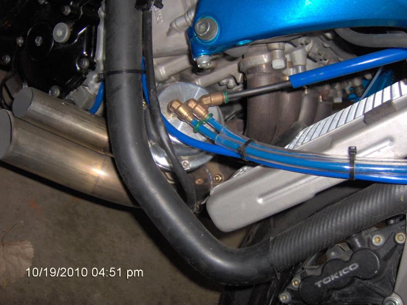

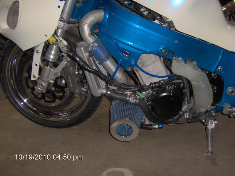

here is pic before he took off his bike i dont hav pics right now as i dont have a camara my daughter broke it lol

velocity
also i would change the oil feed from routing in front of the header that close to routing it from the cold side (this is my opinion on this not everyone's its just how i like to do it)

What is going on with that wastegate is scary! I hate to see what the controller looks like . . . pwall, do yourself a big favor, and have somebody who knows what he is doing install this turbo for you. And get the thing mapped properly . . . you will save money in the long run, and avoid the headaches.
You are saving a nice chunk of change on the kit, don't skimp on the most important part - the proper install and tune!
Anything less will be :blowingup:

dang look at the dents in the up pipe and where someone mounted the fan switch
and as Frank pointed out what is with the wastegate lid?
do your self a favor and do not do this kit yourself
