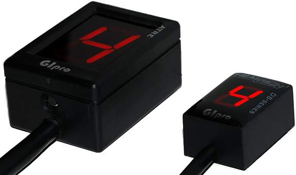

Actually, there are now two models of gear indicators for the Hayabusa.
The GIpro w/ ATRE has the TRE feature and is the one most owners on the site have.
Mounting Photo Gallery is here:
Buy Now: GIpro GI Pro Gear Indicator Advanced TRE Suzuki and Kawasaki motorcycles | Pashnit Moto
You also have the the X-Type Gear Indicator. No TRE feature, and a bit smaller. It's more universal and requires a bit of wiring to install vs. the plug-n-play of the ATRE model. Have them in stock.
GIPro X-Type Gear Indicator for the Hayabusa.
Buy Now: Gear Indicator X-Type for Motorcycles from GIpro GPX | Pashnit Moto
Difference in size. GIPro w/ ATRE on the left. X-Type on the right.
