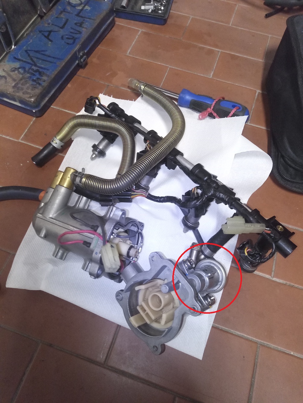

I can state that Quantum pump replaces 100% OEM pump with no issue. Proof is I did it two years ago.
On the picture, black blue one is Quantum, Gray white one is OEM. Unmounting everything ain't difficult, pay some attention and remember to clean also the Fuel Pressure filter that's not specified in the manual. FP filter lies below the Fuel Pressure you see marked in the red circle.

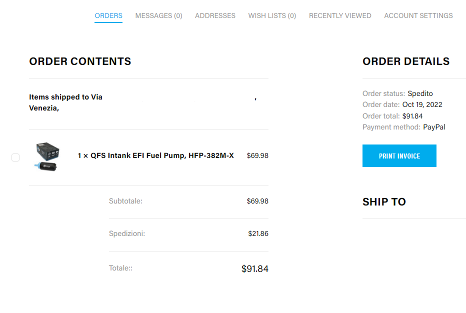

For the model see attached order I did

Hi Quart, so I am seeing that this is a direct drop in replacement for the fuel pump that lives inside the external housing. This is awesome and exactly what I had been hoping for. I have the fuel pump assembly apart for cleaning and replacement of all the filters last year so I remember the little screen hiding under the regulator. Thanks for this.
Not to quibble, but I see it on their site, as I do on your order that it says, in tank, but it clearly looks like OEM external and under some headings that same part number is listed for other bikes as external and intank. So its a fairly universal pump it seams.
But you say you did it with this exact same model number and had no issues. Just drop it in and hook the wires up?
You may have saved my bacon so thanks!

Quart, you were 100% correct. The quantum pump dropped right in and after priming the pump and injectors long enough to scare me it started right up. So thanks for saving me over $1000 on the OEM.
