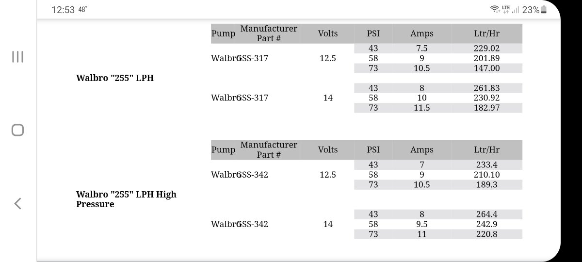

Whats a good external fuel pump good for 350hp-400hp max that doesn't draw a lot of current.
I want to down grade from a Bosch 044, do I have to re tune the bike if I replace the pump with another one?
or should I beef up the electrical system for more output?

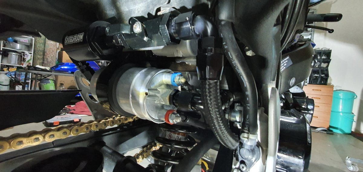

Yes, it does get hot there, but not nearly as the pump got sitting at the back of the engine, under the fuel tank .. Vapor lock was unavoidable before I moved the pump .. Now I only get it when I sit in traffic on a hot day ..
Any suggestons ? I'm all ears ..
Like this ? Still gets vapor lock on hot days (80+) when you sit in traffic .. I'm betting that the FPR and the secondary fuel rail soak up a lot of heat from the engine and radiate it into the fuel ..
My pump is located in my tail. I haven't ridden it yet in summer to heat to say if I will have problems or not, but the previous owner sure did. he didn't mention any issues.
