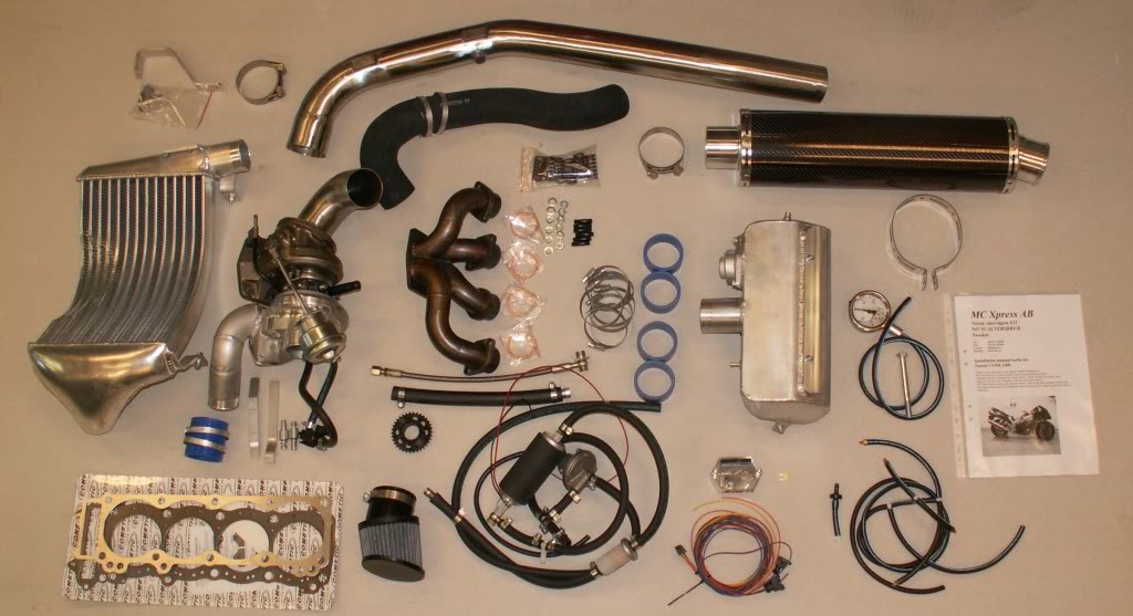

I might be the owner of a gen II come next week. With that said im been grave digging and research whatever turbo info i can enlighten myself with. im very interested in the intercooled-stock internal route like the impressive and exprensive RCC stg 1 ultra. but in the midst of research ive stumbled across mcxpress stage 1 and i went ahead to contact Erik for more info:
"Hi J,
I use to run about 80 kPa turbo pressure (=11-12 psi)
The power on the rear wheel use to be just above 300 hp at this pressure.
The price is 44000 sek for a complete kit. (1 USD is about 7,4 sek for the moment)
The freight home to you is 1130 sek.
The compression ratio must be lowered with a thicker base gasket that is included with the kit.
New adjustable cam sprockets are included.
New clutch springs are included.
The deliverytime right now is about 2 weeks.
Best regards Erik Marklund"
What it comes down to is roughly $5900 shipped for a 300hp intercooled quality kit.
I asked further questions about his bike i.e. ECU edited, valve work and ect
How about the full exhaust, im sure this questions a dead horse but arent they restricting to turbos to some degree?
Anyone have any experience with their kits, gen II kits in particular?
