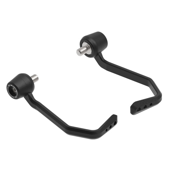

I would spend the money on aftermarket levers instead.
Most all have some sort of design to help prevent crash damage, as well as more adjustment than stock, and depending on which, can fit your hands and fingers better.

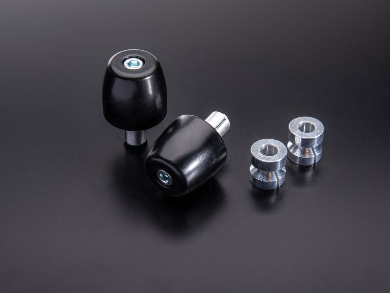

No bar ends yet except for the stock Suzuki ends. I want to get the stainless steel mirrors and heavy bar ends from Spiegler:
I really like the bar-end mirrors at the top of the page in your link.
I also currently have the heavy bar-end weights.
The problem I have is that I want to use both the weights and the mirrord, so the best solution is wider handlebars.
As I would have to move the grips and controls in an inch on each side, in order to have room to clamp the mirror to the 7/8" bar(mirrors come with 7/8" or 1" diameter mounts).
I considererd turning the roughly 1 3/8" bar-end to 1" in the lathe, and clamping the mirror(s) to them, but the rubber mount may transfer enough vibrations to make the mirrors appear blurry.
So, now do I buy wider 7/8 bars, or a 1" riser and 1" fatbars(maybe gold, lol)?
I find the visibility of a good bar-end mirror far superior to factory mirrors, and I had planned to use them again anyway.
Have you decided which mirrors or bar-ends you're going to use yet?
Here are the current version of the large/heavy bar-end weights from Spiegler look like.
My kit cap with the bar end-caps, but I sent them back for these, I put them on a few months ago.
