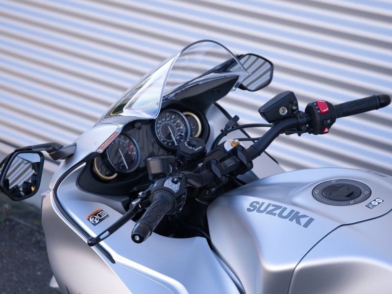

Gen 3 'busa has been dropped off at dealer to have ABM Superbike handlebar kit installed.

I hope these pictures give an idea of where the handlebar is now. I can definitely sit more comfortabley on the bike and a one hour ride I took yesterday was pretty comfy and confidence-inspiring. I will ride it more and give some more impressions.
I can say without reservation that the adjustment made the bike into something I will want to keep and go for long rides on. Before, I wasn't sure.
I've just recently converted my '99 Gen 1 with ABM top yoke kit and Renthal 754 Road Low bars.
I'm a mechanic with 40 years working in the trade, and I did the job at home, it took 4 hours but I was working at a slower pace than if I was at the shop.

@chobers It appears your bike turned out well, you will enjoy cruising long trips on it, just as I do now on my Gen 1.

I don't have anything added to the bar ends. I think they are what came on the original Suzuki clipons, but the service guy was on the phone when I went to pick up the bike so I couldn't ask. I'd like to get heavier weights and bar-end mirrors, maybe.

However, it looks like they replaced the stock bar ends, which fit perfectly. I only rode an hour but didn't notice vibration. I might go with some heavier ones, especially if they'll give me some more room for bar end mirrors.
