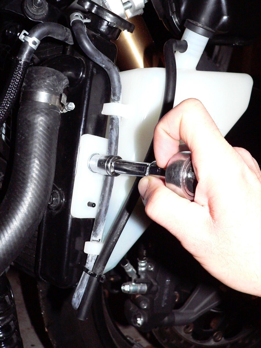

I just did a gen 1 to gen 2 swap everything except motor and forks including rewiring a gen 2 cluster to the gen 1 ecu... I didnt read everyone's replies so sorry if I'm repeating anything. The gen 2 is about half the size in terms of thickness. It sits on the right side and attaches to the radiator. The gen one is on the opposite side attached to the frame if I remember correctly and is about twice as thick . You can probably fit a gen 2 on the opposite side ..but its going to be backwards and you would probably have to drill into the frame to mount it. In my personal opinion, I would just spend the extra few dollars on a gen 1 and save yourself the headache. I went through alot of headaches to make certain things work on the conversion.

gen1 bottle is on lh side, screwed at the frame covering a bit the clutch sleeve
gen2 bottle is under the rh fairing screwed at the radiator
and i guess that any change of the bottle and its place would bring no advantage at all
it makes no sense (to me)

The bottle must help prevent an overflow but that's not going to happen unless the engine overheats.
The way it works is the radiator expels coolant to the reservoir when the coolant expands. When the radiator cools, the coolant gets sucked back to the radiator. If the reservoir ever fills up, the coolant drains out of the top of the reservoir down a tube and runs inside the fairing, the overflow tube doesn't even reach the bottom of the fairing to exit.
Remove the bottle and P-clip a tube from the filler neck nipple to below the bike staying clear of the exhaust. If the coolant ever gets hot enough to expand above the filler neck on the radiator, you would loose that much coolant rather than having it flow in and out of the bottle. Check the level in the radiator when cold and if it stays up, you don't need the bottle. You may need to top off the radiator with distilled water and coolant mixed 50/50 if the engine gets really hot and of course, the rear tire might be getting wet with coolant if it does vent. Coolant is probably not as slippery as oil but more so than plain water. It seems doubtful a lot of coolant would come out unless the engine overheats.
