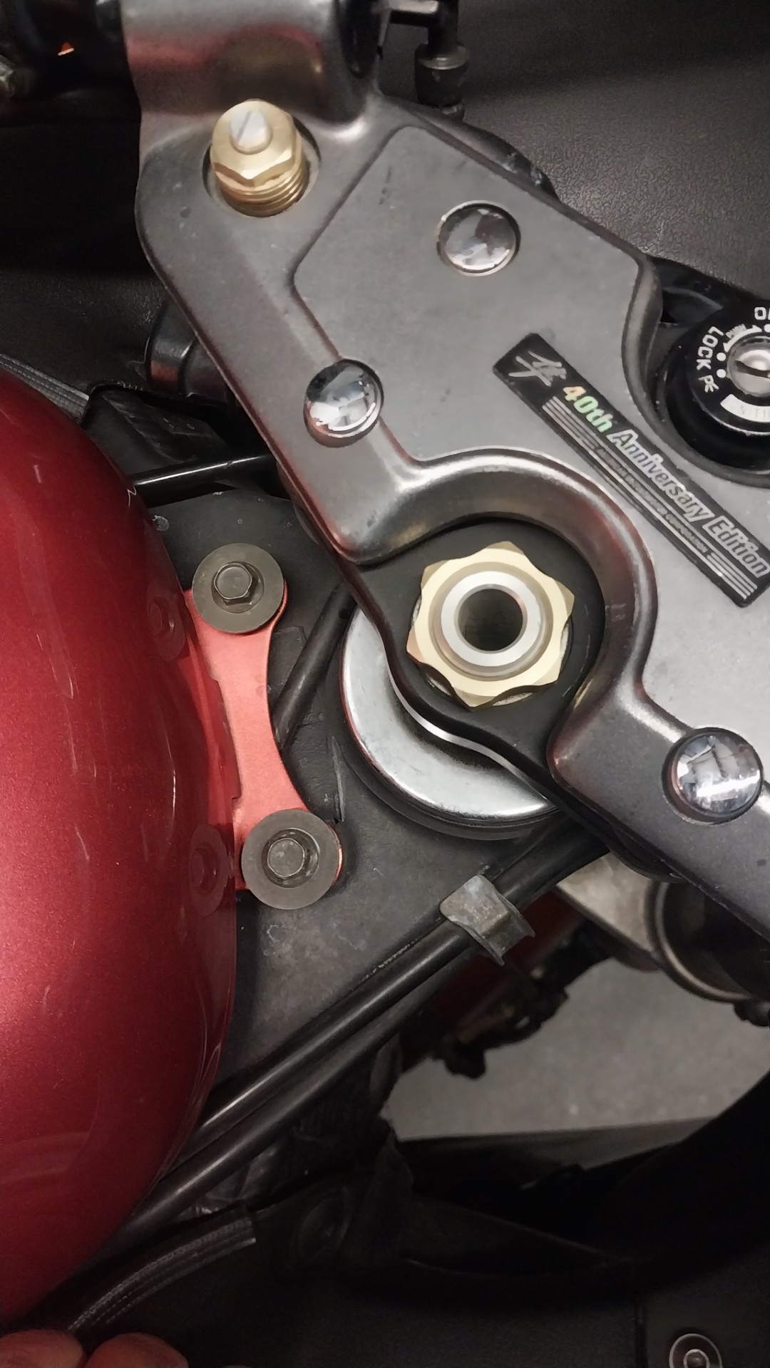

I have a 2005 Gen 1 and I was wanting to know what all sizes of allen keys I will need for it
Not near sockets so can't confirm those, but I believe: Tank bolts are 10mm, rear handlebar mount bolts are 10 or 12mm, windshield bolts are 3mm allen, fairing bolts are 4mm allen, handlebar "Frankenstein" and seat bolts are 5mm allen, chain guard and top black pieces of fairings are phillips.
BlueBacon
Jul 17, 2020
635
1,077
Thought Gen 1 front tank bolts were 4mm Allen. That’s what my 2000 is
Weird...only busa i've had so IDK :D
