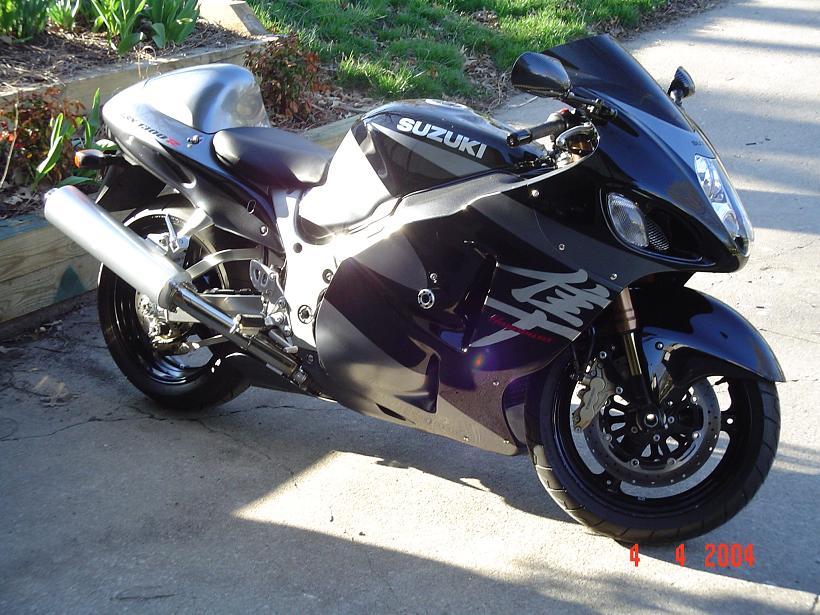

Most sliders I have seen screw into a body mount hole. Regardless of the size of the slider I would think it would snap at the stem. So the fall causes the frame to take a blow, then the slider snaps assin' up your plastic anyway. Here's a pic. Btw, frames cost more than plastics.

Yes, they do. I thought I had a better pic of the front view showing the sliders, but this is all I have right now. I've got the plastics off getting ready to put my new undertail on but can provide some new ones this weekend.
