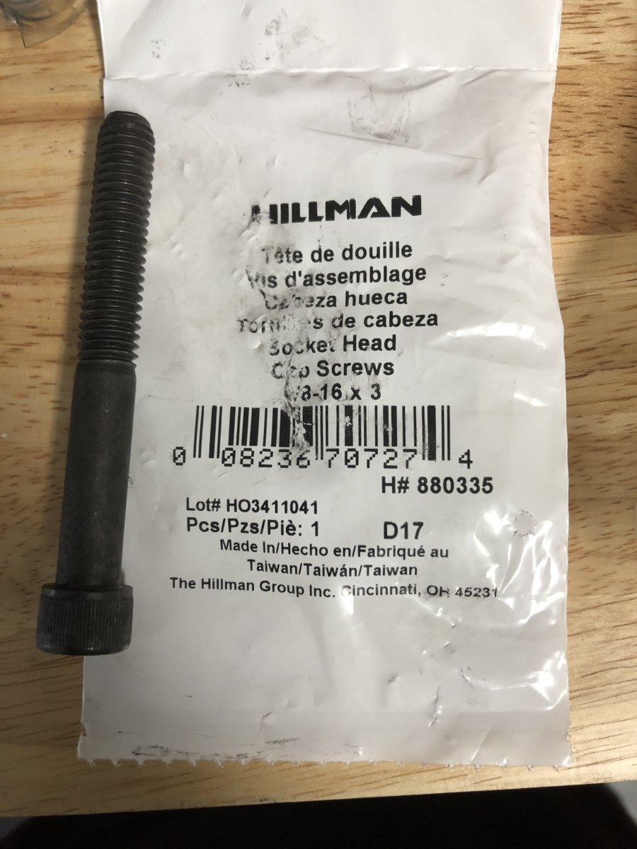

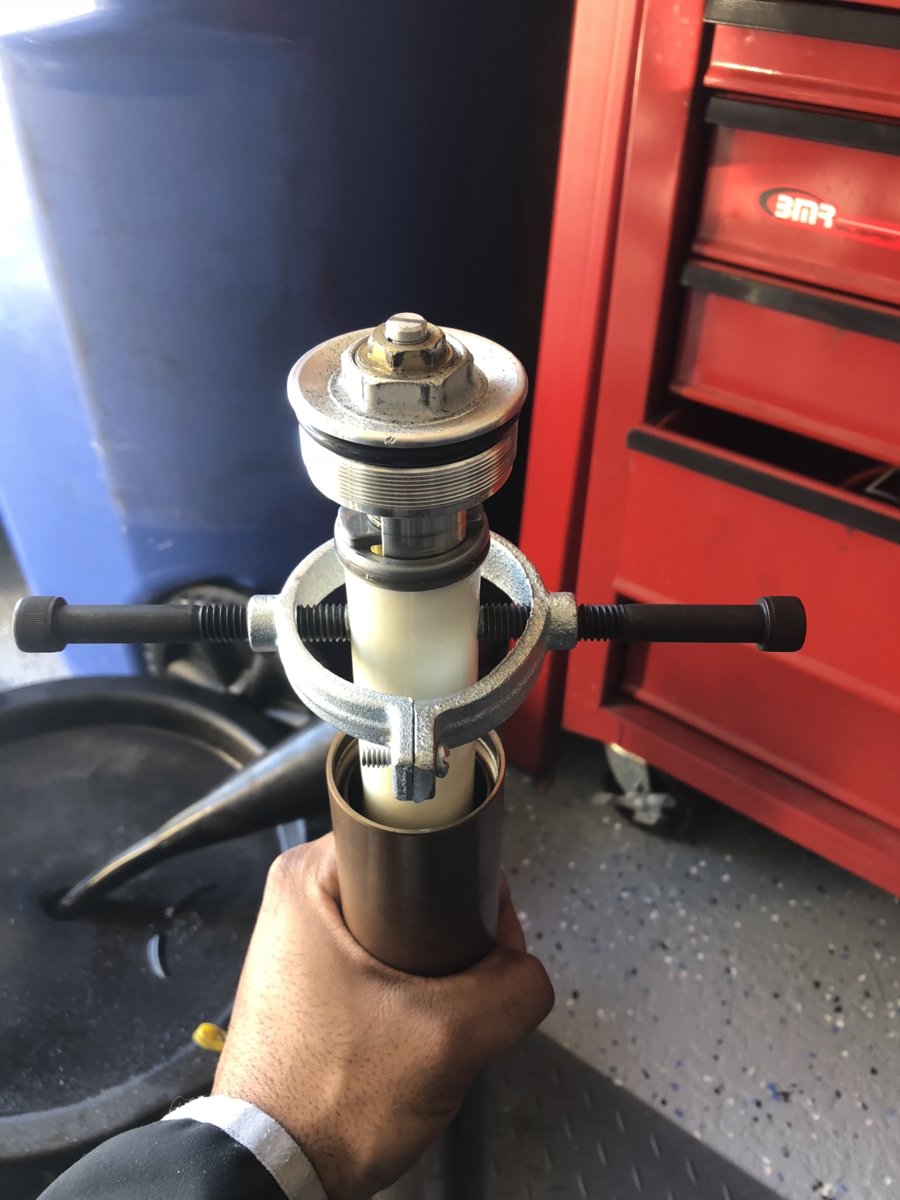

I found a YouTube video of a guy doing the seals on his GENII and he used this homemade tool. I copied his setup and worked like a charm coupled with a ratchet strap to compress the springs
