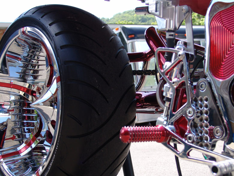

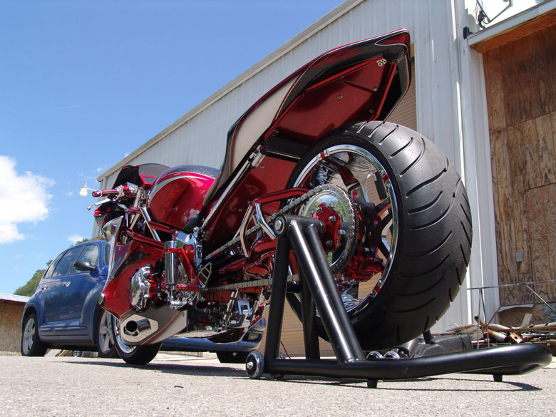

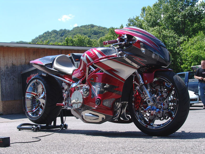

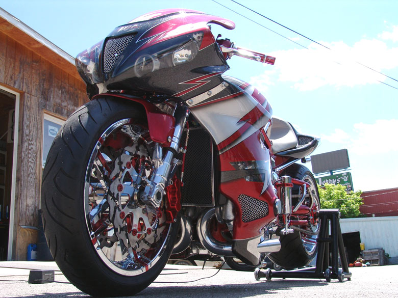

Some quotes from SpidermanSS who posted the pics on gixxer.com
"We've had a TON of messages and emails wanting to see our Suzuki Haybusa that we drew to build for the www.metrictv.com sportbike build off...
Here's a few images....! The bikes were revealed today and we are pretty proud of the bike! Check it out.. > I'll post up stats and info later as we are filming here in Vegas right now but it's the only twin turbo busa we know of... Everything is one OFF custom built... It's insane...
ENJOY and if anyone is in Vegas this week swing bye and see us.. The bikes will be on display on freemont st thursday and friday..."
"It's the only twin turbo busa that we know of.. at least in the usa... Everything from the bodywork to the frame, wheels etc.. all one off stuff we built at our shop.."
"The entire bike/entire etc.. was chrome/polished and or translucent red powder coated... The engine is insane. We had gator glass all over the bike to things off... Also there is a BPD 2 standalone engine management system with a AIM data logging dash hiding in the back ground..."
"MORE ..... bike has nitrous also and a shot of the blinged out galfer world superbike rotors..."
"We tuned it to 250 hp and left it... Velocity worked with us on the turbo system and with the setup and build (low compression race engine) 500 hp is very obtainable with some fine tuning... But it's not needed "

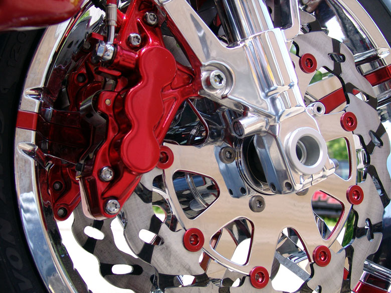

"Specs list :
3D Billet
“SUPERMAN†Front Reservoir Covers
Action Powdercoat
Wheels - Translucent Red Powder coated center strips
3Front Brake Calipers - Translucent Red Powder coated
Rear Brake Caliper - Translucent Red Powder coated
Swing arm - Translucent Red Powder coated
Sprocket – Polished
Ducati Flower Drive Cover - Translucent Red Powder coated
Sub frame pan - Translucent Red Powder coated
Sub frame Under tray - Translucent Red Powder coated
Rearsets – Polished & Translucent Red Powder coated
Nitrous Bottles (2) - Translucent Red Powder coated
Nitrous Bottle brackets (2) - Polished
Frame Translucent Red Powder coated
Clutch Cover – Polished & Translucent Red Powder coated
Clutch Cover bolts - Translucent Red Powder coated
Starter Motor Cover - Translucent Red Powder coated
Engine Block – Polished & Translucent Red Powder coated
Turbos – Polished & Translucent Red Powder coated
Forks - Polished
Triple Trees - Polished
Clip-ons - Polished
Levers (Brake and clutch) - Polished
Twin outlet Turbo Airbox - Translucent Red Powder coated
ANT Video Screen Monitors - Translucent Red Powder coated
AIM Dashboard - Translucent Red Powder coated
Side Panel Covers -Translucent Red Powder coated
Gas Cap - Translucent Red Powder coated
Pingel Shifter Brackets (2) – Polished & Translucent Red Powder coated
Clutch Adjustment Cover - Translucent Red Powder coated
Shift Rod - Translucent Red Powder coated
Oil Pan – Polished & Translucent Red Powder coated
Wave Rotor Carriers (2) – Polished & Translucent Red Powder coated
Wave Rotor buttons Translucent Red Powder coated
AIM
MXL PISTA Data logging digital dash board (Translucent Red Powder Coated)
APEX
Tuning / Wiring / Dyno /
ANT Racing
Dual (2) Rear View Cameras
Dual Cyclops Monitor Displays (Translucent Red Powder coated)
AVON
Venom-R Rear Tire 250/40R18
AV59 Front Tire 120/70 ZR17
Catalyst Composites
Custom Fabricated Tail Section (hand built utilizing R1 upper slope / MilleR rear upper / CBR 1000rr Seat vents)
Custom Carbon Fiber Gas Tank
Front Section (Custom Fabricated R1 Head light cut outs and Aprilia ram air vent)
Billet Machined Gas cap
Cox
Radiator Grill
Cyko Racing
Custom ONE OFF 3D Billet Wheels (Chrome & Translucent Red Powder Coated)
Cyko Rear bolt cover dish cone
BAZAAZ
BPD II ECU Stand alone Engine Management System
Browns
Chrome Swingarm
Dixon Customs
Custom Upholstery and shaved seat covered in Ostrich skin
Galfer
Front Stainless Steel Braided Brake Lines (Red)
Rear Stainless Steel Braided Brake Line (Red)
Clutch Stainless Steel Braided Clutch Line (Red)
Race Modified Lines with inline mounted Line Coolers on all Braided Lines
World Super bike Front Brake Rotors (Show Polished with Translucent Red carrier inners and carrier button mounts)
Race Wave Rotor Brake Disk
Gator Customs
Complete Painting, Bodywork Customizing and Gator Glass
Painted Handle Bar Control covers
Gator Glass Tail Section (transparent red and clear panels)
Gator Glass Rear Tail light system
Gator Glass Rear Turn Signals
Gator Glass Tank Striping and Custom upper tank flanges
One OFF custom side panels.
Hand inlayed and flanged turbo side air vents
Gator Glass Front Turn Signal System
Gator Glass Clear Side Panel openings (exposes engine)
Mesh Aluminum Covers Tail section vents (2)
Mesh Aluminum Covers Side Panel turbo vents (2)
Mesh Aluminum Cover Front Ram Air Vent
Gator Glass front “Twin Turbo Nitrousâ€
Combined Windscreen into front Upper bodywork
Combined Headlight/covers into front Upper bodywork
Gator Glass Front Upper bodywork (5 distinct “ghost†lighted areas)
Combined R1 and Hayabusa Front Fender (SLIM low profile)
Painted Rear Headlight and assembly covers
Custom inlayed polished side panel covers (around exhaust pipes)"
"Greggs Customs
Single Sided Swing Arm – Hand built single sided arm with trellis style hand fabricated rails (Chromed and Translucent Red Powder coated).
Compressed air tank system built swing arm.
Custom Frame – Hand built frame. Factory frame spars were separated and hand built trellis frame spars were built and incorporated into the frame with machined junction points (Chrome and Translucent Powder Coated).
Balled Milled Rear Frame Spars
Custom Ducati Rear Hub drive assembly
Custom Mounted Brembo rear brake setup
K & N
Air Filters (Twin w/ Chromed cap covers)
Koenig
Low Profile Oil Pan (Polished & Translucent Red Powder Coated)
McCoy Motorsports
Custom ONE OFF Adjustable Sub frame (Chrome)
Custom “THUMB HAMMER†Throttle side nitrous purge/activation switch
Clutch Oiling System with Stealth Mounted Oil Cooler
Air Kickstand –Custom switch activated Kickstand
Custom Designed Paint Scheme
Custom One off seat pan
Custom Radiator System
Custom Radiator Overflow Catch Tank (Chrome)
Custom Camera Frame Rail Mounts
Fairing Side cover panels (Translucent Red Powder Coated)
Stainless Braided Air line hoses
Motec
Air and Pressure Data sensors
MPS
Air cylinder – Integrated into air kickstand
Naarden
Hayabusa “DRAG LINK†Lowering Link System
Nitrous Express
Sport bike “WET†Nitrous System with Carbon Fiber Solenoids
Purge System with Carbon Fiber Solenoids
Dual (2) 1 lb. Nitrous bottles (Translucent Red Powder Coated)
Dual (2) Billet Bottle Brackets
Custom Fabricated Nitrous Bottle Fill up junction point
NO Magic Neon
Hyperstrip LED System
CL Pods
Extreme Step Light Bars
Micro Magic LED (Gator Glass)
Wireless Perimeter Remote
Performance Café
Complete Engine Build
Performance Coatings
Turbo Exhaust Pipe HIGH Temperature Coating
PINGEL
Electronic Shift System
Digital Ignition Kill (UP / DOWN) box
Shift arm mount system
Chrome Dual (UP / DOWN) handle bar shift switch
Sport Chrome
Magnesium Chrome Valve Cover
Chrome Frame (4 piece)
Chrome Sub frame
Chrome Starter Cover
Techmount
Video Screen Display Mounts (Chrome)
Trac Dynamics
Race Valve and Lowered Front Fork System (Show Polished)
Tricky Air
Hayabusa Rear Air suspension system
Solenoid Air Compressor pump Setup
Tsubaki
Nickel Plated 152 Link Roller Chain
Velocity Racing
Custom Hayabusa Twin Turbo System
Twin Outlet Turbo Airbox (Translucent Red Powder Coated)
Clutch Cover and Clutch System (Polished and Translucent Red Powder Coated cover with custom red bolts)
Modified Garret GT Turbos (Translucent Red Powder Coated & Polished) 250 HP each (2)
Dynamic (Raked Front End) (Polished)
Custom Twin Outlet Exhaust Pipes (Jet hot coated)
Vortex Racing
Hayabusa Rearsets (Chromed and Translucent Red Powder Coated)
Shift Rod (Translucent Red Powder Coated)
Walbro
Fuel Pump 340
YMS
Billet Machined Handle bar Grips (Anodized Red)
Billet Machined Bar Ends (Anodized Red)"
