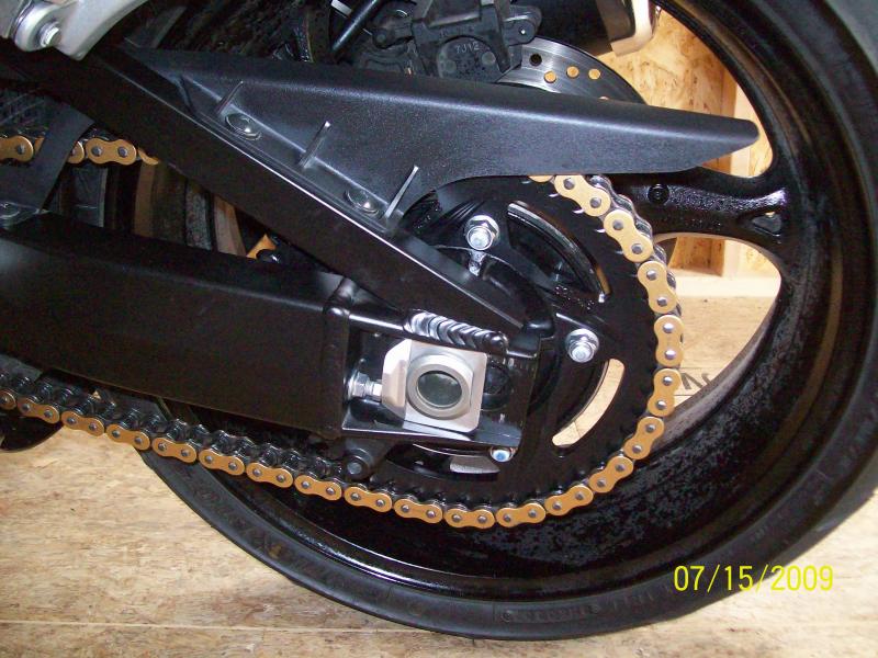

Just got this and need to install it soon. 45t Driven in black.
Also got a set of black ProBolt nutts.
