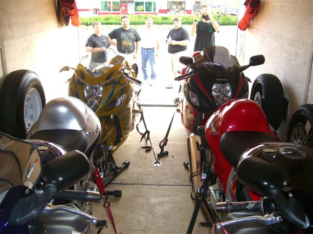

Thanks! I've been looking at the Baxley chocks for my trailer and was wondering about mounting them.
I love the Baxleys. When doing track days, I take them out of the trailer so I can pull right into them whem exiting the track since I take my kickstand off.
