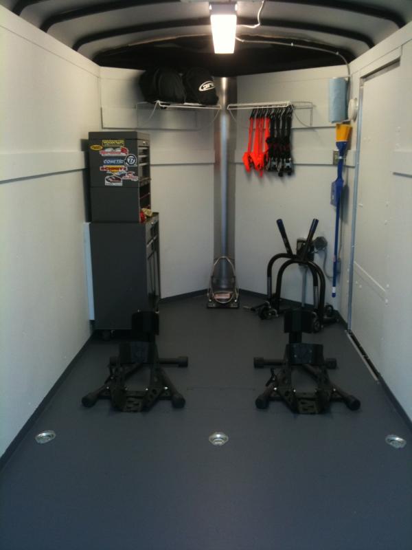

No straps on the Pit Bulls, but is tricky to do by yourself. With that said. You don't have any stress on the bike at all and I have several thousand miles on this set up. Shown are my track bike and the Busa in case I wad up my Gixxer....:laugh:

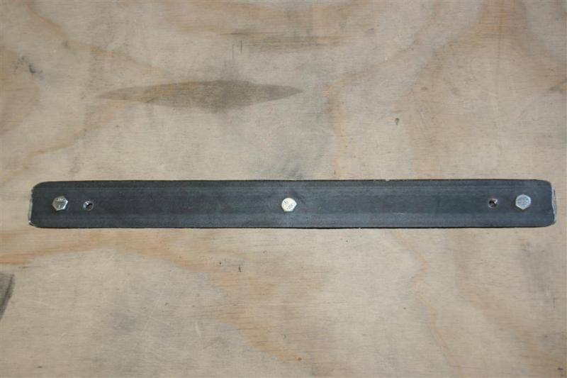

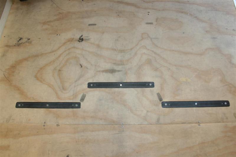

As mentioned, they sell a kit, but for the price you can make your own. I picked up some 1" steel flat bar, 1/4" thick from my 'metal cut to length' supply house. I cut them each about 16" long and then drilled/tapped 'em for 1/4" bolts and also for the mounting bolts.
I then made a template and routed each one into the floor to recess 'em flush to the floor.
I initially made 3 plates for the Baxleys - one up for a single bike and two a little further back for two.
I later added two more for the chocks...just to move the bikes a little further back....I was hauling a longer bike for a friend and needed a little more room. The chocks are in the forward mounts here and you can see the two I added a little further back. Using the rear-most mounts, there is about 2" - 3" clearance from the rear of the Busa to the ramp door...just enough.
