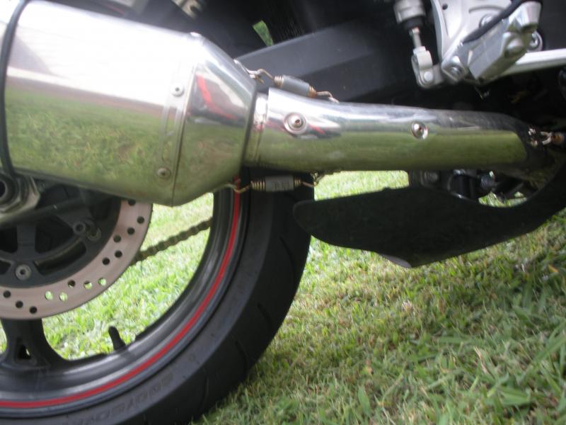

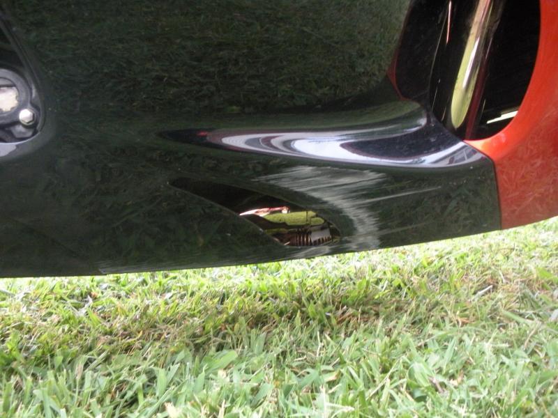

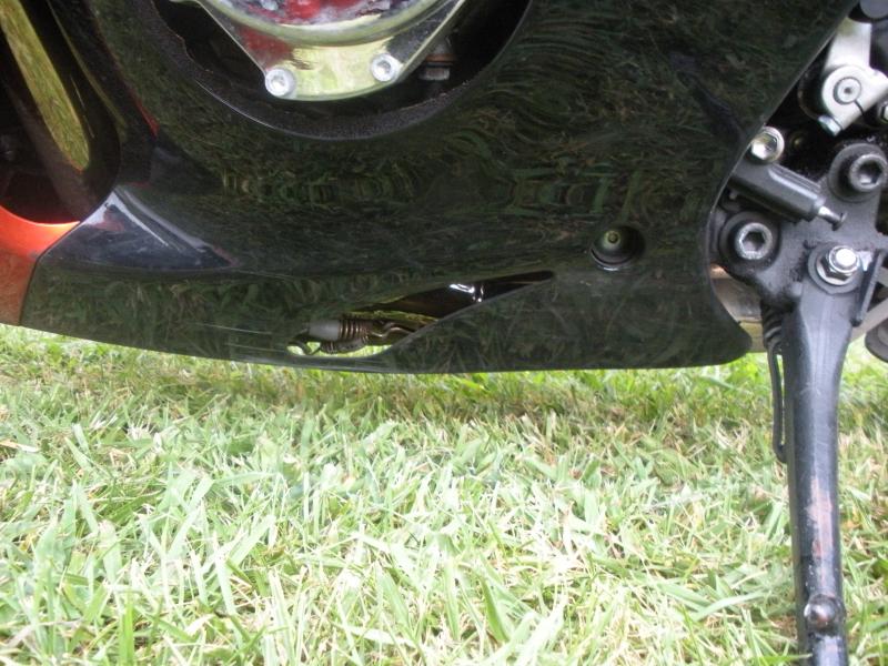

:laugh:I wish i could get on a track, but I used to ride with guys that did, we pushed each other good. Here's a picture of were the scrape will be. It's kinda hard to see, but it's the only pic I have of it now. If you look at the lower fairing, where it goes straight up(directly to the right from the lower chrome end of the exhaust) You'll see the discolored egg shape, the paint is gone. You can only see a small scrape on the front of the black part of the muffler, as the rest are on the chrome sheil on the pipe. The other pipe is much, much worse, as again the right side of the engine is sitting out futher

Damn man those pics are a bit unsettling but props for keeping her wheels down :thumbsup:
