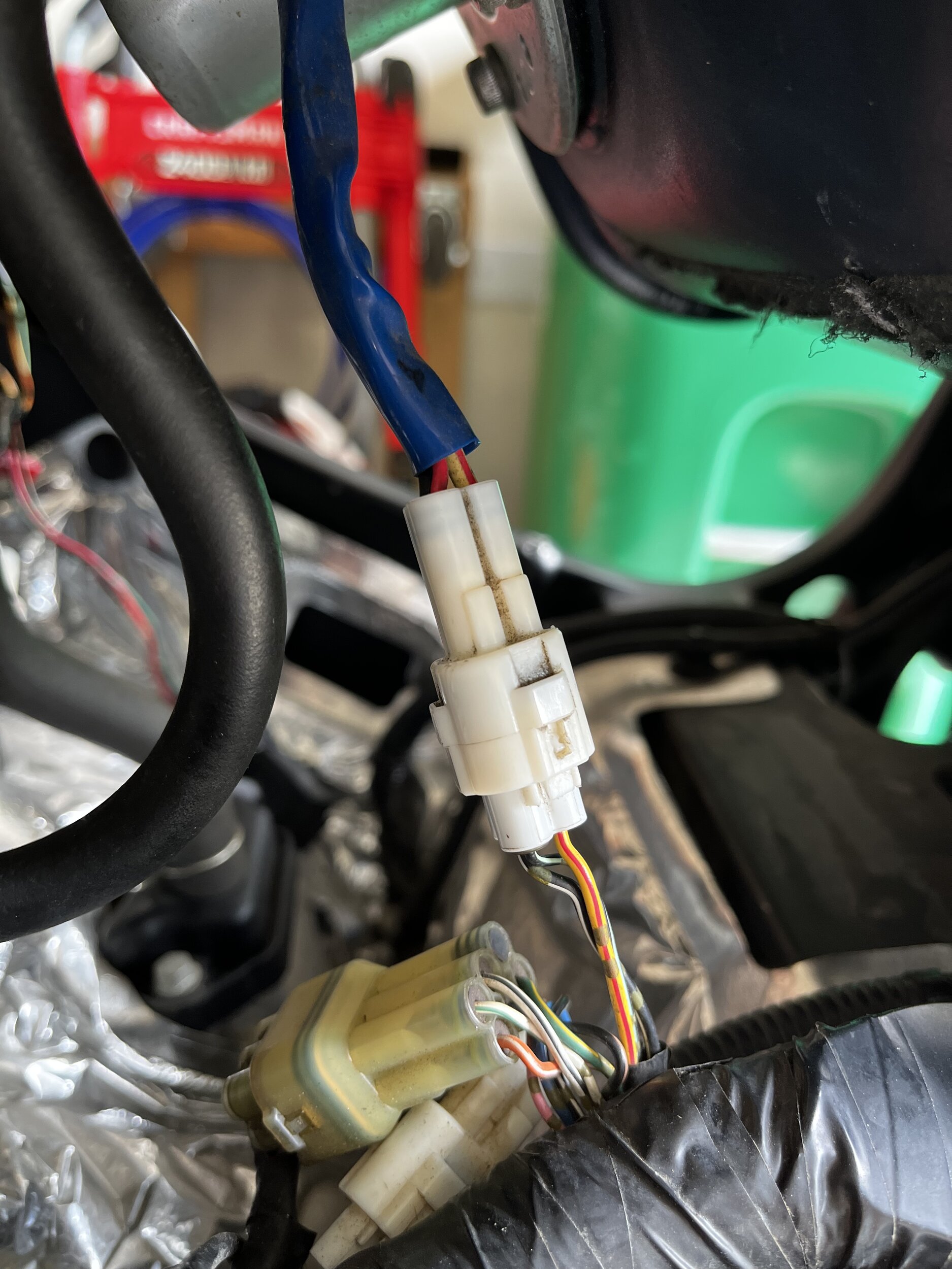

Hey guys… so I did all the recommendations checked the rectifier readings came back good, checked w the Suzuki dealership and it was replaced by the prev owner in 2021, purchased a battery load tester and readings came back good (battery is brand new less than a month old). Started checking the cabling around the fuel pump and noticed that one of the wires on the connector for the fuel pump was coming out as I took it apart the cable came out of the plug all the way. I retighten the connection and sealed the bottom of the connector so the cable would stay in place. So far, I did a handful of cold starts, let the bike run until hot and try to restart yet no issues - starts on the 1st try! But still havent taken the bike out on the road to do an actual test drive so, once all this T-Storms clear I’ll give it a shot. Not sure what the issue truly is and hope the fuel pump plug had something to do w the issue. The negative terminal is no longer getting hot still hot but not hot enough for it to catch on fire. Any additional comments & feedback please feel free to share but thought I should share an update.

Bad news guys so, back to square one! Bike still dying on me… I ordered a new Yausa Battery OEM recommended and debating on ordering a new rectifier but want to get your feedback on a reliable rectifier. If you check EBay or Amazon these things range from $25 to $300. Found an OEM replacement (new) for $85 plus shipping and also a rectifier plus the stator for $149. I looked at videos for the replacement of the stator which seems easy but a bit intimidating as I do not have a precision torque wrench and thanks to YouTube knowledge they mentioned that a torque wrench is needed. So plan a) starting w new OEM recommended battery, b) getting rectifier (asking you guys for a brand recommendation aftermarket or stick w OEM), c) anyone have any pointers when replacing the stator ?
