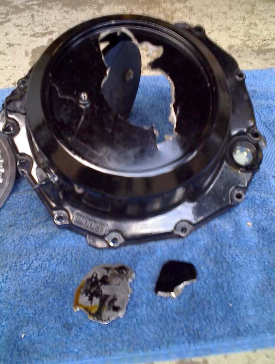

next big trouble can be the long studs in the clutch
they have to be glued in with loctite 266 or so or you may get this very expensive horror
