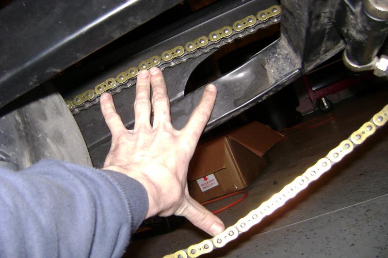

Has anyone had trouble with an EK ZZZ chain? Today I put on my longer chain (9inches over) and set the boost controller to run 11lbs in every gear +4lb spring. The chain was adjusted between 1/4 and 1/2 inch of play and within 15 minutes it made a bad sound when I switched from second to third gear so I pulled over and checked it out. The front sprocket was missing a tooth and the chain had around 4 inches of play in it. I used the chain for about a month last year at 4 lbs of boost and it didn't stretch much at all.
I will take a picture of it, it had about 1000 miles on it and quite a few 1/4 mile passes so I figured all the stretching was already finished. It didn't make it 10 miles today before it broke the new front sprocket and stretched the chain. I was riding it hard but did not expect that to happen.
My new sprocket:oops::oops:

almost sounds like the chain was sitting on the sprocket and not in it, but you would have noticed that right away :dunno: Is the rear adjuster in the same place you set it?
Chain won't stretch that much.
That is the first thing I checked and the adjusters did not move. I'm planning on running 19-45 sprockets instead of 18-42 and run the chain a bit tighter than before.
I have never heard of an ZZZ stretching that much. Mine stretched about 1/2'' and then never moved....but I was running a stock motor :dunno:
