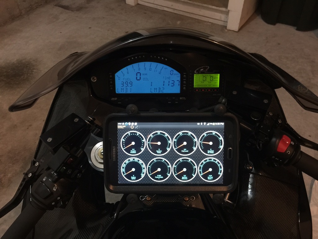

So, for an even grand you get it all in one box:
Boost data / Wideband O2 data
Datalogging (built in SD card slot)
Airshifter / Killbox
Ignition retard / amplifier
Secondary fuel controller
ECU
Shift light / Autoshift
Mine even has bluetooth built in to connect wirelessly to my phone or tablet and display diagnostic engine info and digital gauges. You can even make tuning adjustments through the app on the fly. :)

Did any of those display units come in the 1k price tag? What software are you using to tune it?
The "Display Unit" is just a standard Samsung Galaxy 8" Tablet running the ShadowDash App and the MSDroid App. The Aimsport Strada and the AMS-1000 are also not included in that price :) The software is TunerStudio, here is a link:

Shifty, I am assuming that is a ram mount in the stem holding that tablet. How comfy are you with that? For instance, would you be comfortable with a smartphone with an 1/8th app (which I saw, dunno how accurate it is but says gives you a tree sim, records your 60', 1000 and 1/8 times). I would love to be able to practice launches with an app.
