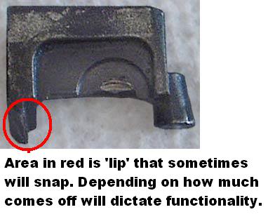

Third-Broken extractor-This was most common on the forty caliber guns, especially the model 23.
Sometimes enough of a portion of the extractor would break and prevent shell ejection sometimes just the lower lip of the extractor would break.
Gun would still function but upon inspection you could see the tip snapped. Get a spare.

"Third-Broken extractor-This was most common on the forty caliber guns, especially the model 23.
Gun would still function but upon inspection you could see the tip snapped. Get a spare"
Had this happen to my 19...9mm
I had some "hot" ammo:whistle: and after a few clips through it I got a physical pop out of it and the magazine dropped out.
Ordered a few new parts and better than new now:thumbsup:
