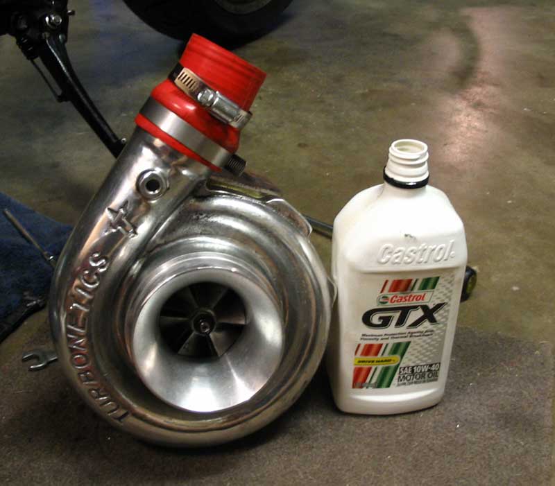

51
ditto run one, drag racers need not apply (your choice).
I wanna keep this little thing whirlin though...
